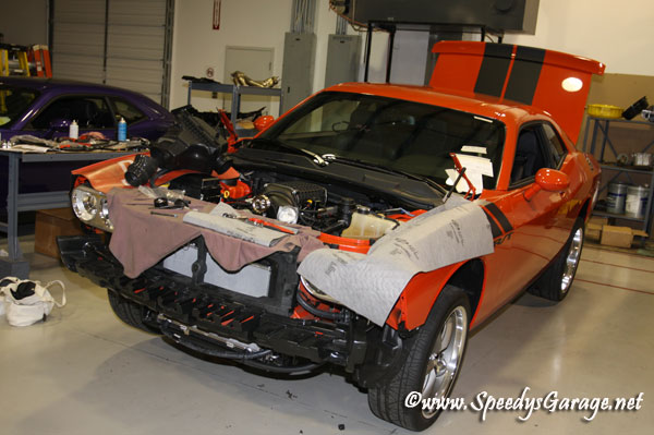

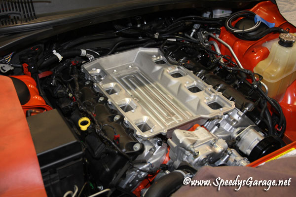

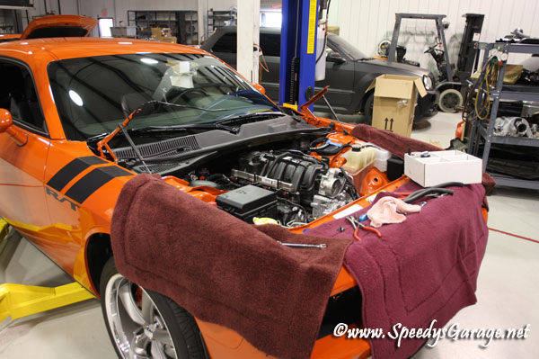

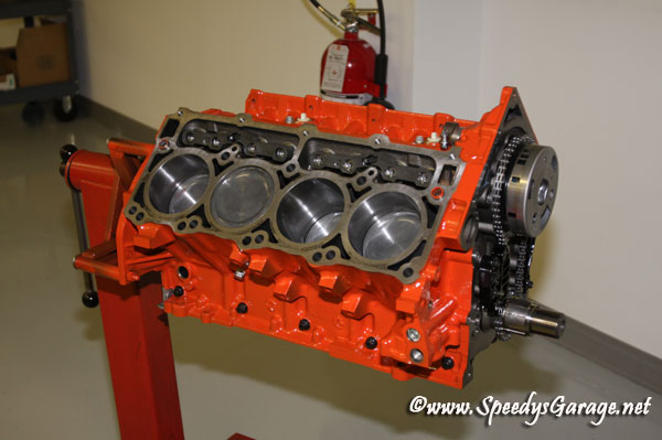

Ok I'm back...car's phenomenal. Since you guys are sort of the competition I gotta keep my numbers a secret but lets just say torque was well north of 600 ft/lbs
Here's a few pics from the build.....Arrington is starting to get in to Camaros as well and they are a TOP NOTCH shop so I'd urge anyone looking to do a build to contact Alex over there and see what they offer for your rides. These guys build NASCAR engines and really know what they're doing. Multi million dollar facility and equipment.
There'll be some videos and more pics up on my website as well.
Dropping the car off
Forged Pistons
Assembled short block with blower cam
The tear down
The build up
Tuned on the dyno
Speedy1975 is offline   Reply With Quote

Originally Posted by toesuf94 View Post
Sexy...love the fact the motor is Hemi Orange...did they do that or is the engine orange from the factory?
Beautiful car. And I am really glad to see all of the above posts were from car people, not fan boys.
Thanks man. The block was black from the factory. I requested it be custom painted Hemi Orange. I'm not sure what kind of paint they used but it's THICK. It actually made sharp edges feel rounded off. Whatever it was I was told it was a two part product that Mopar uses for their engines, so it's a factory paint whatever it is.
