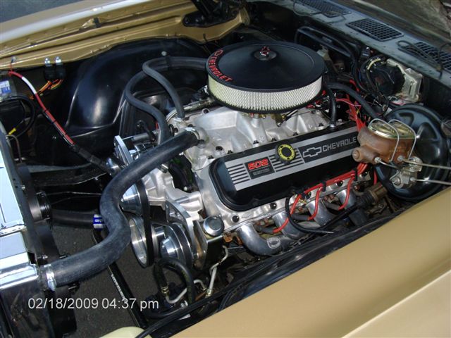

No replacement for displacement. There is nothing like a BBC. They have so much torque. My 70 Monte has a GMPP deluxe 502 in it and it is wild. 502hp at 4800 and 567 torque. Over the years I've owned so many BBC and very few SBC engine. It's hard to beat.

guess since we are sharing bbc photos i'll contribute
