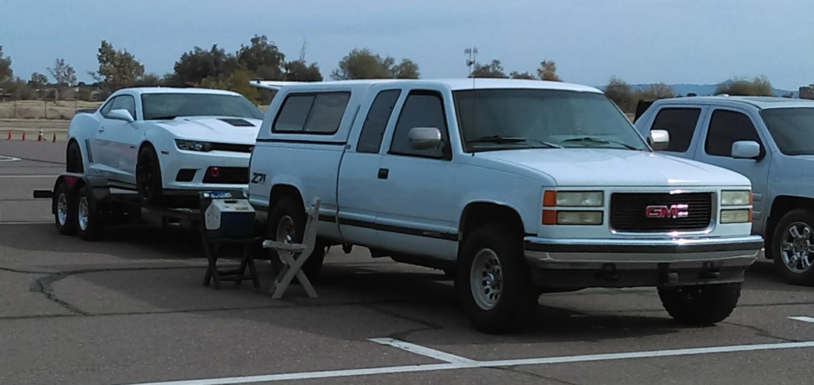

I was looking for a 6.0 2500 when I stumbled onto this baby. '01 2500 HD, Allison 5-speed and a torque monster 8.1L big-block! No touch screens, heated seats or other candy-ass crap that doesn't belong in a truck. And it only has 66K miles. This should tow my Z/28 or Z06 with ease. Don't be afraid to jump into something a bit older, good advice for trucks AND women!

Damn that is sweet!!!!

Originally Posted by ariZona28 View Post
A note of caution if you decide to go the half-ton route be sure to do your research on Gross Vehicle Weight and towing capacity. Just because a truck CAN tow, say 12,000 lbs or so doesn't mean it can do it SAFELY. There are actually laws that pertain to this subject and if you're involved in an accident with an overloaded rig YOU may be at fault. I decided to go a bit overkill for future expansion with the 2500HD as my '94 1/2 ton damn near made me s#!t my pants one time during a freeway panic stop.

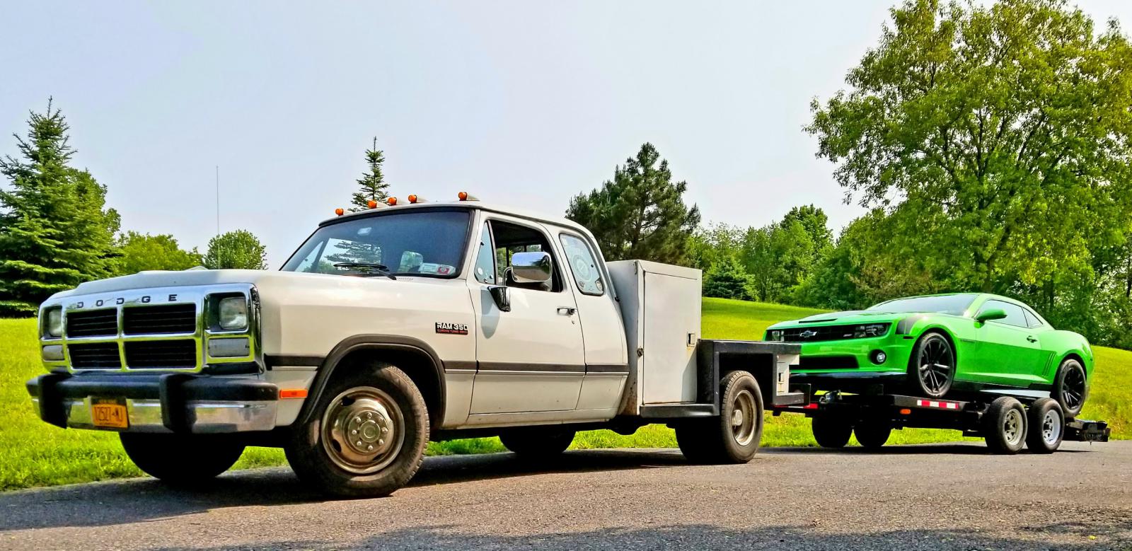

This is sound advice - weight and wheelbase are your friends when towing, especially bumper towing. I've towed with a bunch of stuff over the years, but my trusty old Dodge is the here for life!
