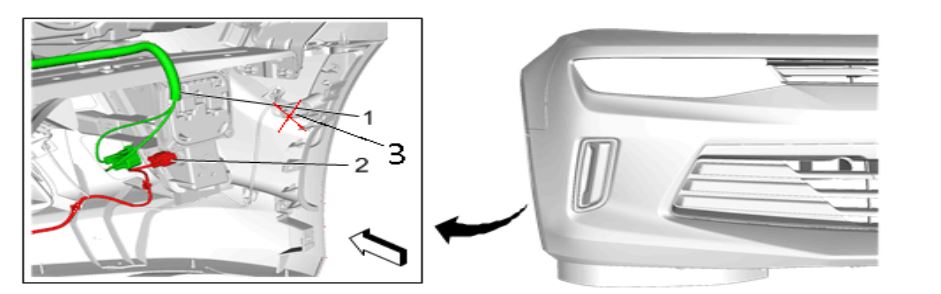

I bought an LED Bow-tie from a Chevy Dealer (Part No. 84329529). The part fits the 2020, but the instructions are for an older car (printed 2018).
The light comes with a "splice harness" that gets plugged into a junction box behind the passenger's side of the bumper. When I look for the junction box (reference in picture,) I cannot locate anything electrical in that area. The only thing I have there is a plastic honeycomb box as part of the bumper.
Any ideas where the jumper plug wire gets plugged into for a 2020 3LT?

It's suppose to be plug and play... Without pulling off the bumper, grill, and wheel well liner I don't know where that plug is. The pic in the instructions don't seem to match mine.

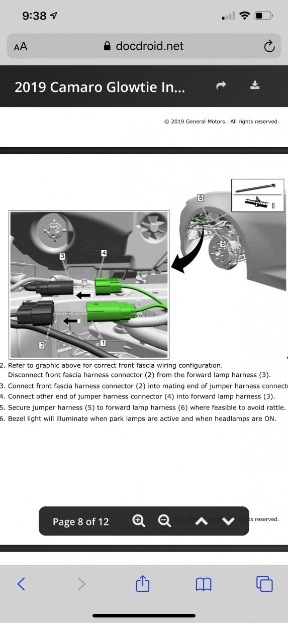

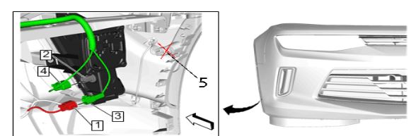

It appears to be on the driver side on your car not the passenger side. Maybe the following link will point you in the right direction.
https://www.docdroid.net/9luD7mq/201...ns-pdf#page=10
That worked! Interested how they changed it for 2018 to 2019 and 2020.
