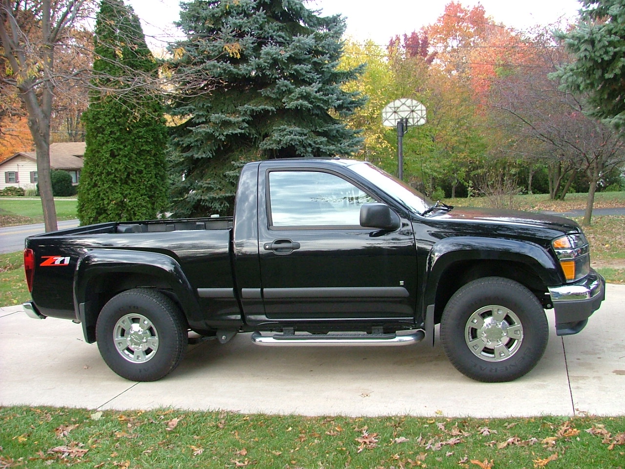

A stock 2007 Z71 regular cab short box Colorado was delivered to get the ball rolling as well as a LS7 crate motor and a T-56 six speed transmission. With this combo being stout to begin with, we knew we were going in the right direction…but once again ATI Pro Charger jump on board with one of their F1A’s to give this LS7 some more horsepower…aprox 1100hp with 14lbs of boost.

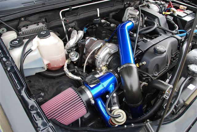

Originally Posted by nova View Post
Well, I was hoping to see some mods to the original Colorado 5 cyl (turbo or super hint hint) but this is still darn cool.
Sort of like this one we did awhile ago...
It was cool for sure, but completely different creatures...as you can imagine.
Yeah thats kinda what I was looking for.
Wish I could find a production kit to give my little blue truck some more towing power but I just don't see it happening given the size of the market.
Hahn Racecraft builds one for the Colorado's...ours was used for the prototype.
