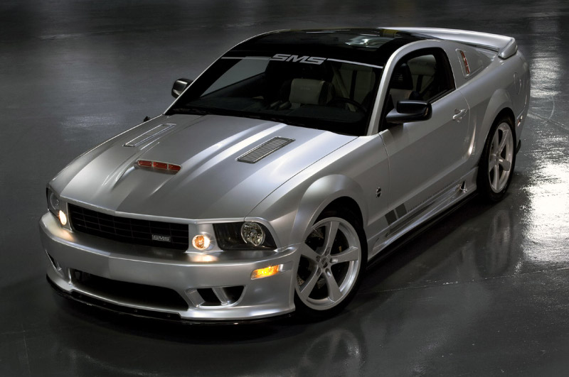

I didnt see a thread on this car so I decided to add one. Its said that its performance is nearly on par with the S7....we'll see. Did anyone else notice that they totally jacked the 4th gen hood scoop. Heres a few tidbids, and a long article
Key functional and aesthetic innovations:
SMS 720 HP Supercharged 5.0L Aluminum Block V8
SMS CNC Ported Saleen Supercharger
SMS CNC Aluminum Heads
SMS Red Butterfly™ Induction System
SMS Light Blade™ LED Tail Light System
SMS Billet Aluminum Watts Link System
SMS Cross Drilled 15" 6-Piston Front Brakes
SMS Cross Drilled 12" Rear Brakes
SMS Two Piece Billet Aluminum Hood Vents
SMS Carbon Fiber Side Splitters
SMS Carbon Fiber Diffuser Fences
SMS Red Butterfly™ Quarter Intakes
SMS Chromosome™ Silver Paint

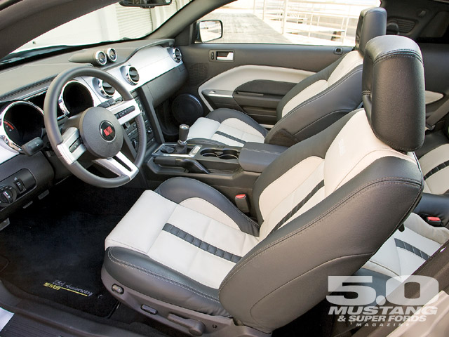

SMS Leather Grip Billet Aluminum Shifter and Shifter Bezel
SMS Leather Dash

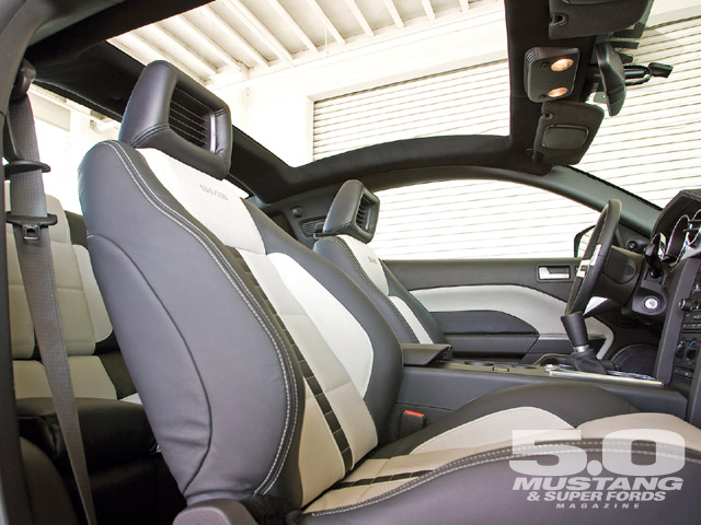

SMS Leather Two Tone Door Inserts
SMS Leather Two Tone Seats
6-Speed Transmission Performance:
720 HP/612 WHP
667 TQ/565 WTQ

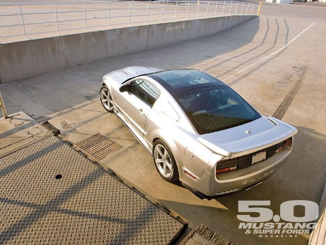

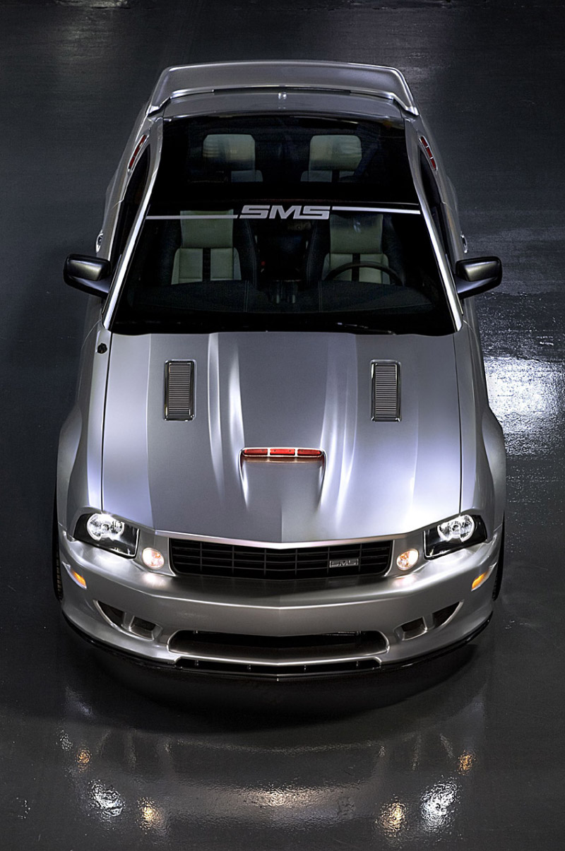

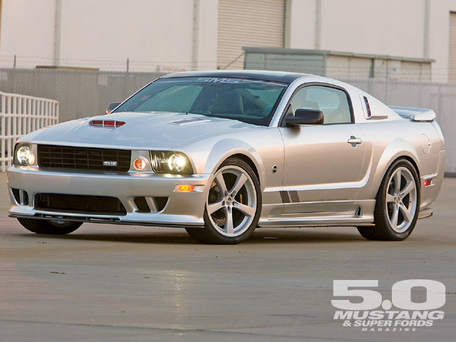

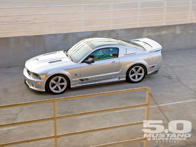

Those looking closely will notice the carbon-fiber air splitters all the way around the lower edge of the car. These aren't Saleen parts, but new SMS pieces for the 25th Anniversary car. The rear diffuser is also unique; the better to accommodate the large, single-exit center exhaust outlet.
The glass roof is a current Saleen option, but we're sure you noticed that the hood and its integrated scoop and throttle blades are fresh. In fact, the hood is a composite carbon/fiberglass SMS part, newly tooled for the anniversary car, but you can bet your last lug nut we'll be seeing this engine lid again on future SMS-production Mustangs.

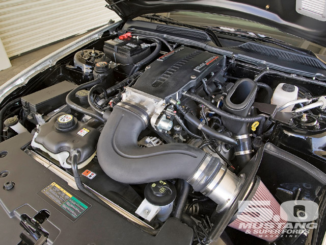

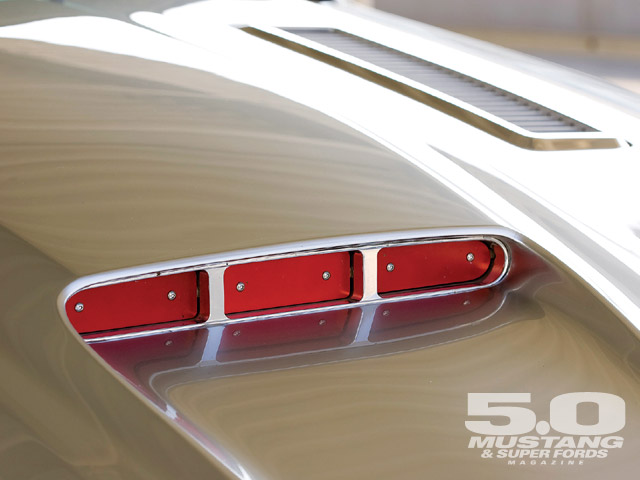

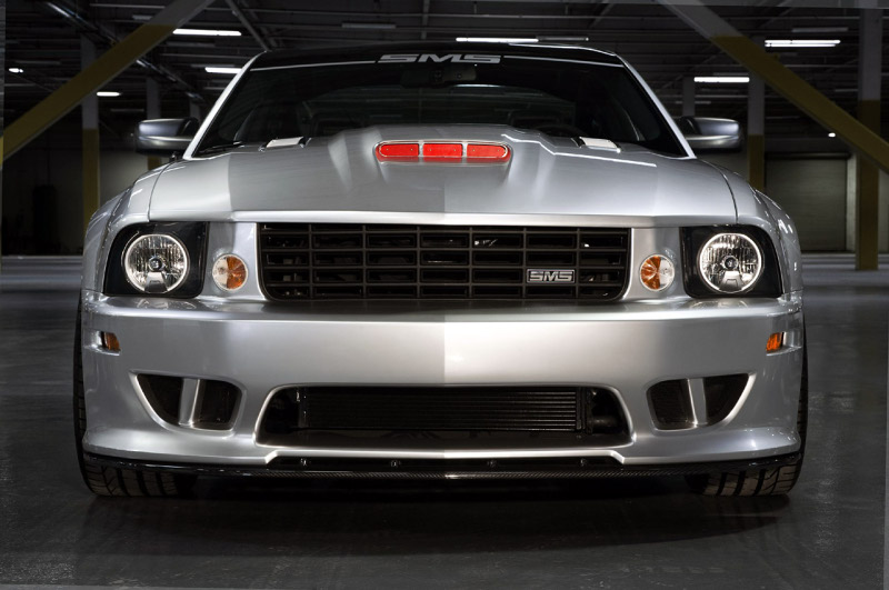

Those dragster-like "throttles" are a fun bit of trickery SMS calls the Red Butterfly Induction System. Yes, the red butterflies open and close in response to driver input; the command comes from an electronic controller and the power through a stepper motor in the hoodscoop. SMS engineers were sure to make the butterflies open when rapping the throttle at a stoplight, so they're a dead cinch to impress. The entire system is separate from the powertrain control module-there's a switch on the throttle pedal-so emissions legality isn't affected.
The more mechanically astute will realize that no, the red butterflies aren't the actual throttle body, but rather a nifty, operable cold-air intake. In practice, air passes through the butterflies, runs through a duct built into the hood, then through a separate duct forward to the cavity surrounding the open-element air filter in the usual spot behind the driver-side headlight. The air then passes through the air filter, an SMS 100mm mass air meter, and the throttle body atop the Saleen supercharger. SMS is already offering the air filter, air dam, and 100mm mass air as a cold-air kit. They're the start of what promises to be a full line of hot-rod and appearance parts.
Past the intake trickery awaits a standard Saleen supercharger, as used in the last few years of Saleen production and offered as a popular aftermarket kit. Below the blower is a stock bore, stroked, 4.6 Three-Valve engine. You're forgiven if you wondered whether this is one of the prepped 5.0 liters used in the Parnelli Jones and other Saleens. We wondered, but were assured by SMS chief engineer Billy Talley that the 25th Anniversary engine is a one-off, prepped Mustang GT plant.
"We started with a standard, aluminum-blocked Three-Valve engine, dropped in a forged 3.800-inch stroker crankshaft, Manley rods, and our own piston design," Billy says. "Compression is knocked down to 9.2:1."
The heads are also stock Three-Valve castings but ported on SMS's new CNC-machining centers. The valvesprings, retainers, and such were upgraded for a good 7,000-plus-rpm operation, but the timing chains, tensioners, and other valvetrain parts were left stock. Also stock are front-engine-dress items such as the water pump and air conditioning.
Oiling is another stock area, save for the windage tray, which was clearanced to fit the stroker crankshaft through the CNC machines. Billy emphasized that nearly all the machining operations to this engine were developed on a computer, then whittled out by the CNC machines.
Besides the noodling that went into the optimized piston dome shape, the real work on this engine went into the supercharger and manifold combination. Like the body kit, the blower and manifold assembly was sourced from Saleen but massaged on SMS' CNC machines for optimum airflow.
"On the intake manifold and supercharger, well, there were a few issues, so we worked on the shortcomings-the choke points," Billy says. "We have a few new pieces of equipment on the shop floor, so we got rid of the casting issues, CNC'd the manifold and intake tube, CNC'd a blend on the throttle body, cut down the shafts It was a blueprint thing on the throttle body."
The work to the mass air and inlet tube was major. This is hardly surprising, as our experience with big-power screw blowers has shown that the inlet side is critical to feeding their voracious appetites. Thus, SMS emissions/driveability specialist John Spruill finally indulged his need to build a full-on 100mm mass air meter, complete with, "a large venturi [and] a nice shape to transition from the air filter." In fact, John said the cross-sectional area throughout the inlet tube is held at a constant 100mm for airflow integrity.
Unlike other parts of the 25th Anniversary Special Concept, which were hewn from aluminum billet just for a little bling, the inlet tube uses another technology new to the SMS crew: in-house SLS rapid prototyping. This is a Doc Raynoid process where parts are built up from a primordial goo by laser etching; it's the rage in aerospace and Formula 1 but is just making it to the best-equipped tuning shops. In the SMS inlet's case, the material is nylon and held to exacting tolerances, unlike the hit-and-miss dimensions of rotomolded inlets. Again, look for such parts in production SMS cars and its spin-off parts as they hit the market.
On the outlet side, the stock Ford exhaust manifolds and catalytic converters are retained, Saleen mufflers are used, followed by the new SMS center exit "boom tube." This gives the 25th car the familiar Saleen exhaust, where the gases normally exit under the car near the mufflers. During full-throttle efforts, however, valves open to the center outlet, which greatly increases the exhaust exit's area, thus reducing backpressure.

Aiding the bright mood is the two-tone upholstery. Custom-made for the 25th Anniversary car, the leather trim covers firm seats-shades of the Flofits in vintage Saleens-and extends to the door panels. SMS billet-aluminum brightwork around the shifter lends a hint of street rodding to the proceedings, while the shift knob itself is leather-wrapped around an SMS aluminum whittling.

We did open those red butterflies, of course, and the results were grin-inducing impressive. At the risk of confusing those who haven't pedaled true big-block displacement muscle cars, we'll start by observing that the current crop of megapowered modular motors just doesn't hit with the instant torque slap upside the head as a 408ci Windsor sporting a 12:1 compression. But then, those don't pass emissions or gas pumps, either.

5.0 Tech Specs
Engine And Drivetrain
Block
Stock aluminum
Bore
Stock
Stroke
3.800-inch
Displacement
5.0 liters
Crankshaft
Forged-steel
Rods
Manley, forged-steel
Pistons
SMS custom-dome, forged
Compression Ratio
9.2:1
Camshafts
SMS custom
Heads
SMS CNC-ported Three-Valve
Intake
Saleen, CNC-ported by SMS
Throttle Body
Saleen
Mass Air Meter
SMS 100mm
Injectors
Saleen
Power Adder
Saleen Stage VI screw supercharger
Intercooler
Saleen
Headers
Ford, stock cast-iron
Exhaust
Ford cats, Saleen mufflers, SMS center outlet
Transmission
GT500-spec T-6060 six-speed manual
Flywheel
McLeod
Clutch
McLeod dual-disc
Rear Axle
8.8-inch, 4.10 gears, TrueTrac limited-slip
Electronics
Engine Management
SMS custom-tune
Ignition
Ford
Gauges
Saleen gauge pod; boost, charge-cooler temp

performance = nice, looks = bleh

Nose is twisted, LOL
Look where the hood meets the grille
-bobby
I kept looking at that thinking it was my eyes playin tricks on me.
I kinda like the looks of the exterior, its not great, but its not ugly either. The interior i'm not so fond of.

Well, it won't be long before we see a Camaro with butterfly valves on the nose. Based on this and the Challenger, I won't be looking forward to that day
IDK.... on the real this is an unbiased opinion the Chally looked kinda hot with those valves
I don't see the Camaro getting the butterflies but maybe SMS will get the mail slot to work...that what I would do

wow... I think that hood looks terrible... The rest of the car looks pretty good

did anyone else notice the hood doesn't line up with the grill evenly in that last picture?
