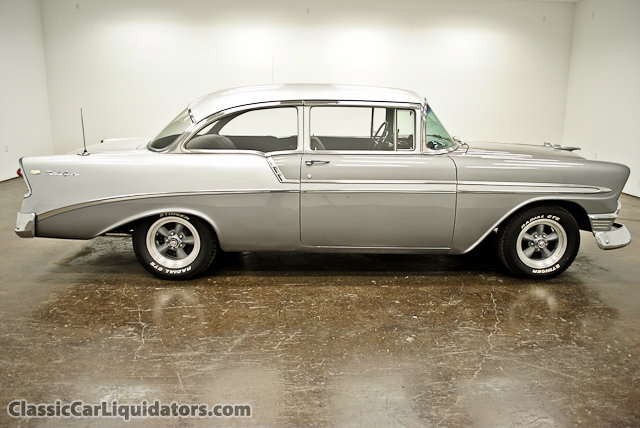

While I am sitting here day dreaming....it is not the exact color but the body style is the important thing.......ONE DAY
I think your Savinis would fit on there. lol

Sav..what...what is this name you speak of.......
