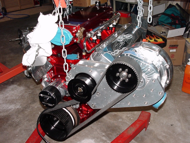

Another pretty decent BBC - 540
1108 hp on 91 octane
Much higher on C-16
