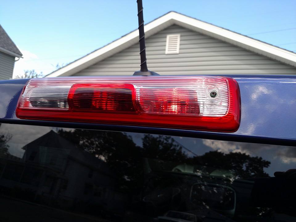

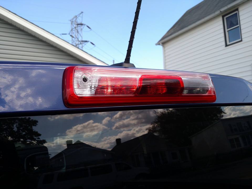

Since I have the tonneau cover on and the new LED bed lights, I decided to turn the stock cargo lights into additional turn signals. I also changed the high brake light to an LED bulb.

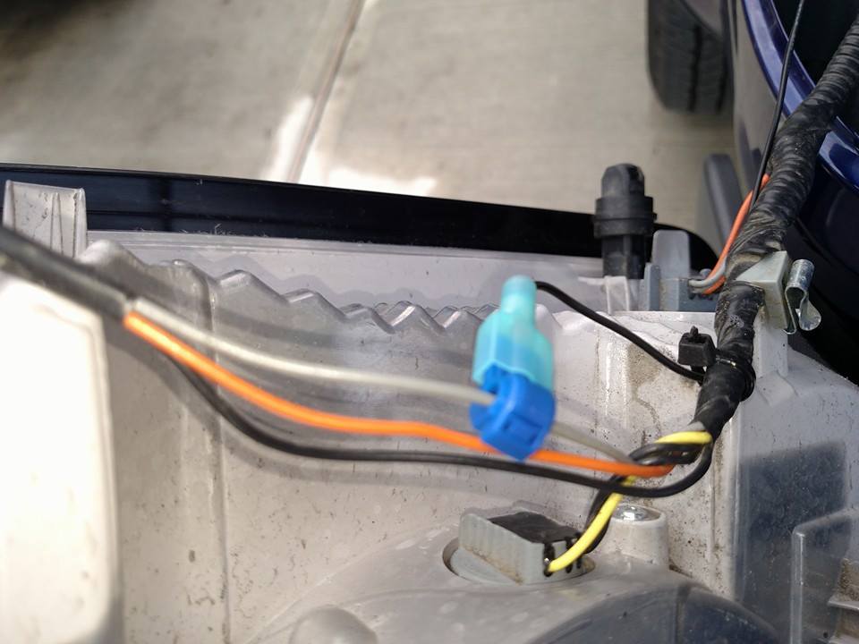

for reference, I already got it figured out, if anyone is curious, for the tail lights, you'll have 3 wires going to the tail lights.
Black - ground
Orange - tail light positive
Gray - turn signal positive
The gray wire is what I tapped into for the mod.

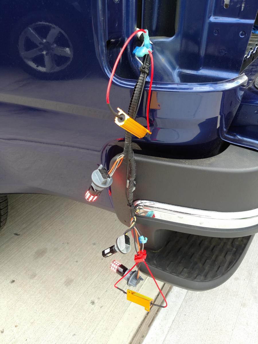

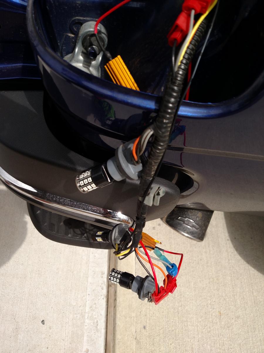

Just an FYI, I changed out my tail light bulbs to LED bulbs (the last LED bulb swap left on my truck) and I just wanted to let you all know, that if you were interested in doing the same, you'll need TWO 50W 6ohm resistors per side. I tried to just use one before both bulbs but the computer still read as a bulb out.
As my pictures show, two resistors per side.
