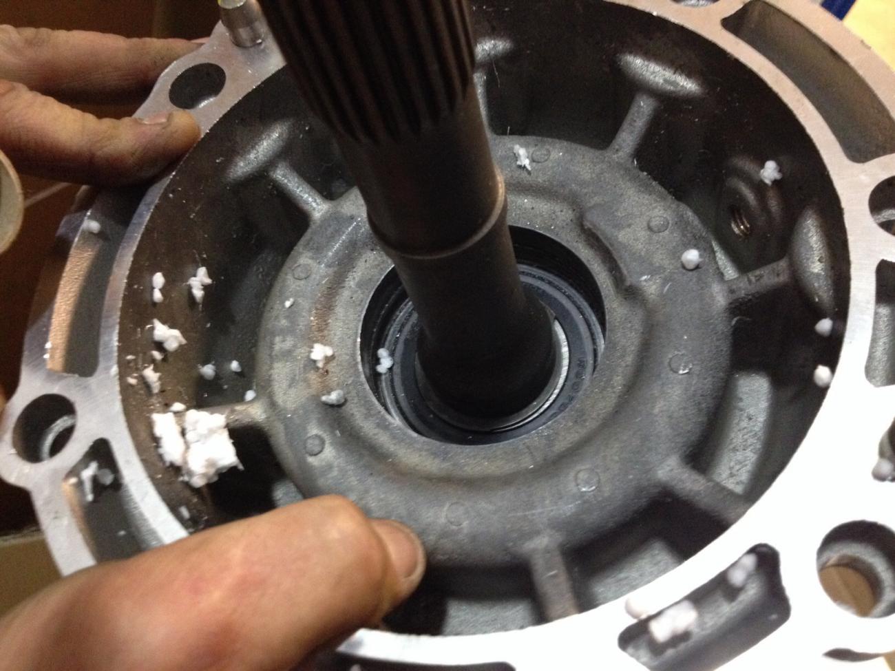

Heavy vibrations around 2200 RPM
Recently I have been getting a strong low frequency vibration and noise starting at 2000 rpm and ending around 2800 RPM. It happens in any gear and even in neutral standing still. Anybody else experiencing this? (6500 miles, 2014 6AT)

I have not, but get it to your dealer right away. As you're experiencing the vibration in neutral, it is very likely a problem with the engine. There have been some reported issues with a small number of balancers failing, and this sounds like it could be. If left unchecked, the engine could end up with serious damage. The other possibility I can think of is a torque tube failure. I'm not sure if it still rotates while the car is in neutral but again damage up and down the drivetrain will likely result if not repaired. Better safe than sorry - have the car checked asap!

The front bearing in the torque tube failed. Full torque tube replacement is underway. This will be my third one in seven months.

Actually this will be my third torque tube, so two failures. The first was at 2000 miles and sounded like marbles rattling around at idle. Failure was in the u-joint rubber coupling at the rear, a known and common problem. Torque tube replaced. The second was at 6500 miles and was a heavy vibration at 2200 rpm. That was a front bearing failure in the assembly. Torque tube being replaced today. I looked over the problem with the mechanic. He will check to see if alignment to the engine is off causing my vehicle to eat torque tubes, but the failures were very different. I have complained to Chevy and will pursue lemon law if it fails again. They are replacing a lot of torque tubes at my dealer.
(Attached is the picture of the failed bearing from today on the engine side of the torque tube. It should be flush with the housing and not have metal shavings around it. It is displaced back about 1/2 inch. You can see a groove it cut about halfway down. Ignore the white packing foam.).
