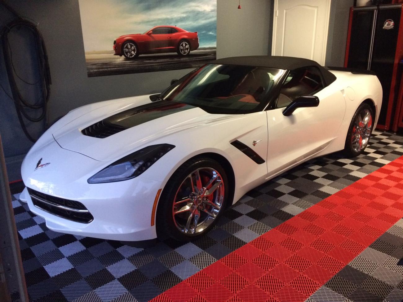

Old 06-05-2014, 07:29 AM   #7
dbevins
Drives: 2014 Corvette Vert
Join Date: May 2013
Location: Delaware, OH
Posts: 10
Here's mine. RaceDeck.
dbevins is offline

Originally Posted by kevin1106 View Post
I went with race deck flooring. Love it!
awesome garage! which race deck tile is that? and how much did it cost if you don't mind?

Posts: 2,299
http://www.bigfloors.com/shop/racedeck-free-flow/
Here you go.
Looks great!!!!
how does this hold up to water and anything else? My fear is water getting trapped under / between the tiles, eventually causing mold blah blah blah. Since it looks like you have a one car garage, you probably don't have to deal with snow. I would as I have a two bay.
Yea, no snow since I don't take Vette out past November. You might email Racedeck with your mold question.

Posts: 34
I've got Race Deck also. As for mold, I've gone through one Colorado winter and no problem thus far. It isn't really that hard to put the flooring down ( 1 1/2 hr for two car garage first install that including trimming where the center wall is 1 ft into the garage.) If I thought there was the chance of mold, I'd probably just remove half at a time, clean and then re-install.
