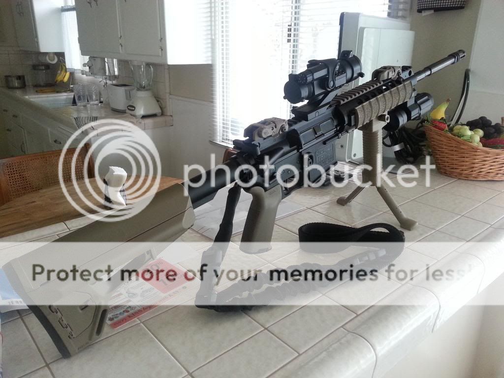

Here's an AR that I custom built from scratch. With a fully loaded 10 round mag it weighs in at over 15 pounds. This is what they weigh if you don't want polymer or plastic pieces. Also as it sits in this pic not including the scope, it cost over $2,500.

If you want light weight or something you can carry you want polymer which as mentioned above is there to keep the weight down. However do your research if you buy a polymer lower, there are a lot of bad companies out there.
My AR has a New Frontier Armory polymer lower and with a fully loaded mag it weighs about 9 pounds.
