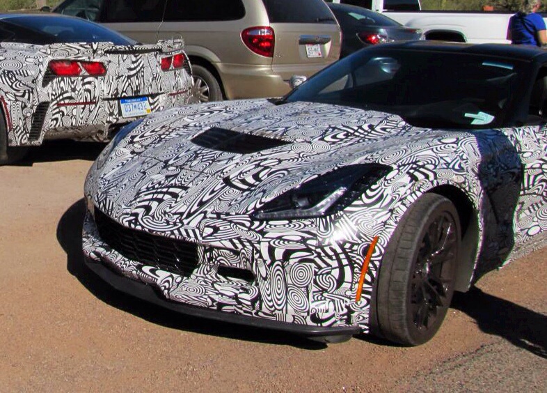

If you add those GM Z06 body-components to a Stingray, might as well add a front solitter as well.
This mule looks like a Stage 1 Z06... due to its less-aggressive front splitter and obviously no winglets. This splitter will likely fit on the Stingray as well.

The front end seems like it will be fairly straight-forward. However, every body panel from there back is different, especially the rockers, door panels, rear fenders and rear fascia. I read in a couple of places all of these are about 3" overall wider. You can see that in the rear photos. While the fenders and fascia are relatively easy bolt-on swaps, you'd need to swap entire door shells (transferring all the other parts from your current doors). And as the rockers are bonded to the frame very early in production and have a lot of parts installed over them, they might well be impossible to switch out without dismantling about half of the car. I admit the look of a Z06 is awesome, but suspect a full conversion of a base or Z51 to the wide-body look a Z06 would be cost prohibitive. By the time you did this and then painted the entire car, you could then actually afford a Z06, and get the supercharger too!
Maybe the aftermarket could step up and offer a bolt-in kit that either skips the extra width at the doors and rockers, or has pieces that bond onto the existing doors and rockers to gain the width.
