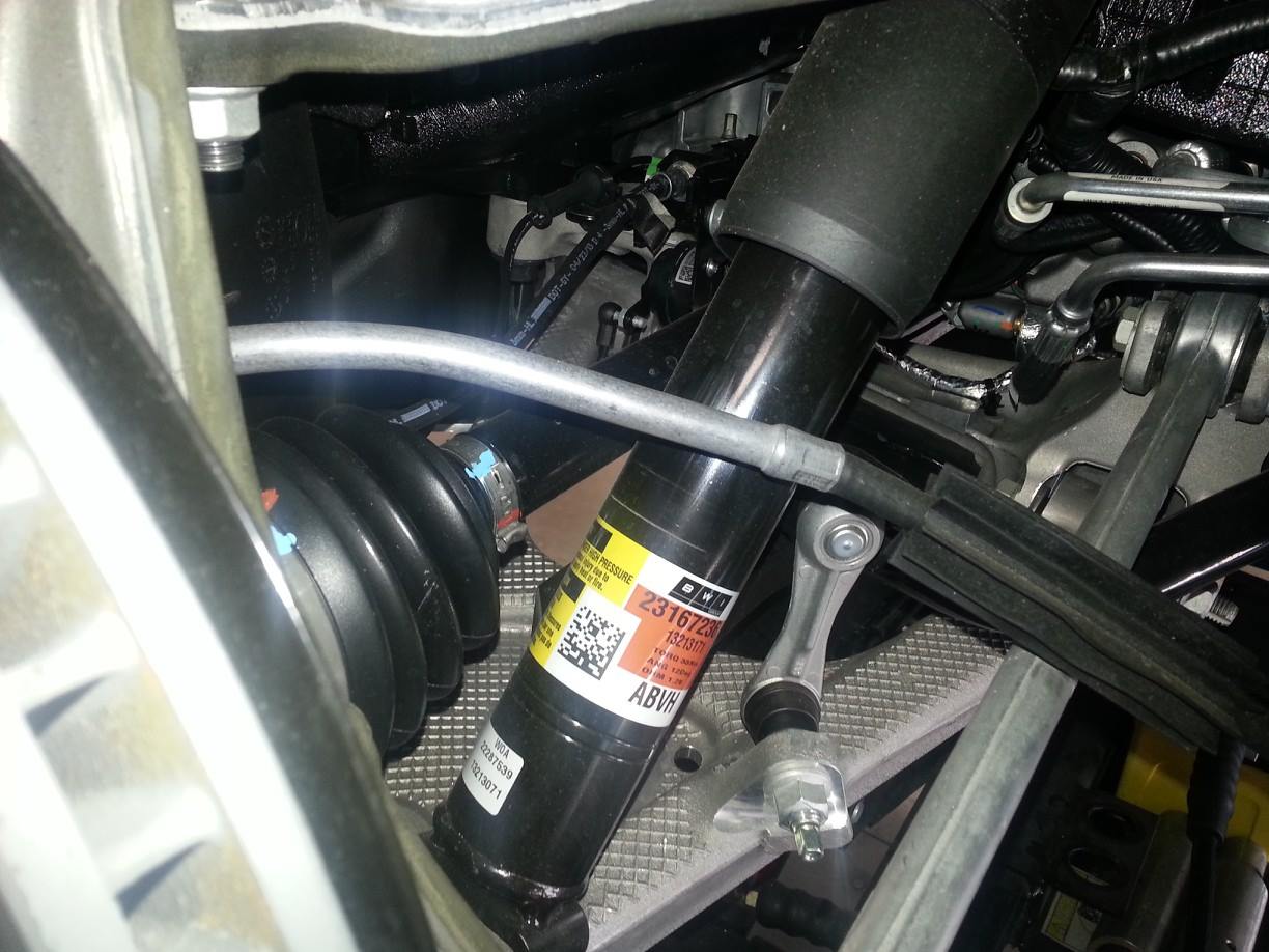

There are a couple of points that look really tight already. An 18" in the back would almost seem impossible. I need to find one that has identical back spacing and offset.
