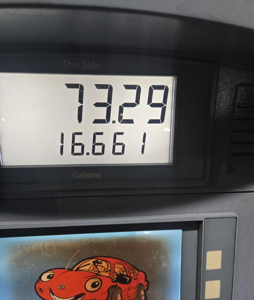

Old Yesterday, 09:30 PM   #25
bishopts
bishopts's Avatar
Drives: 2017 2ss 6mt
Join Date: Mar 2024
Location: dallas
Posts: 1,485
She thought the gas gauge quit working. Turns out she was just completely out of gas
