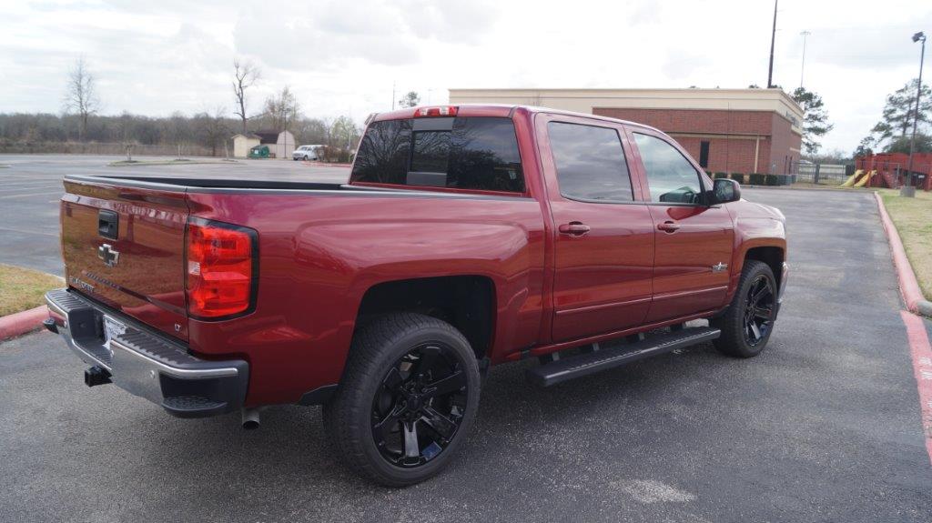

Good call on GM's part... hopefully that switch remembers the last setting too.
and I really did get an 18 with the thought of avoiding this stuff.
