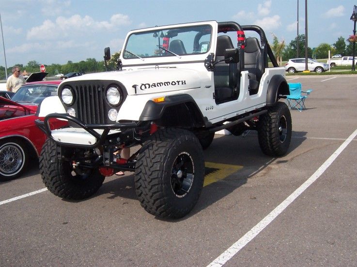

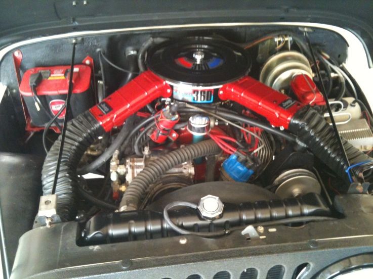

Old 01-18-2012, 04:02 PM   #8
Here is the Jeep.
Not a lot of guys on here familiar with this type of fuel delivery set-up.
It's more for the old folk I guess.
But the Jeep is cool as shit.

That is not a straight 6. Nice Jeep though!!
Pedders Pace Car Package, Injen CAI, Flowmaster AT, AAC Lighting, ZL1 fascia/skirts, RKSport Ram Air hood, vented fenders, painted stripes (Gary's Customz), Honor and Valor badged (Thank you, John)
garcmol is offline   Reply With Quote
Old 01-18-2012, 04:35 PM   #12
I went out and got the pics off the net. lol
