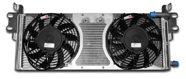

Update: Well, the upgraded heat exchanger arrived late this afternoon, so hopefully everything will get installed early next week. Here is the unit going on the car:
This is a dual-pass unit with twin Spal fans that pull about 1500cfm through the exchanger. We're hoping to see 30-50 degree cooler IAT's with this in place.
