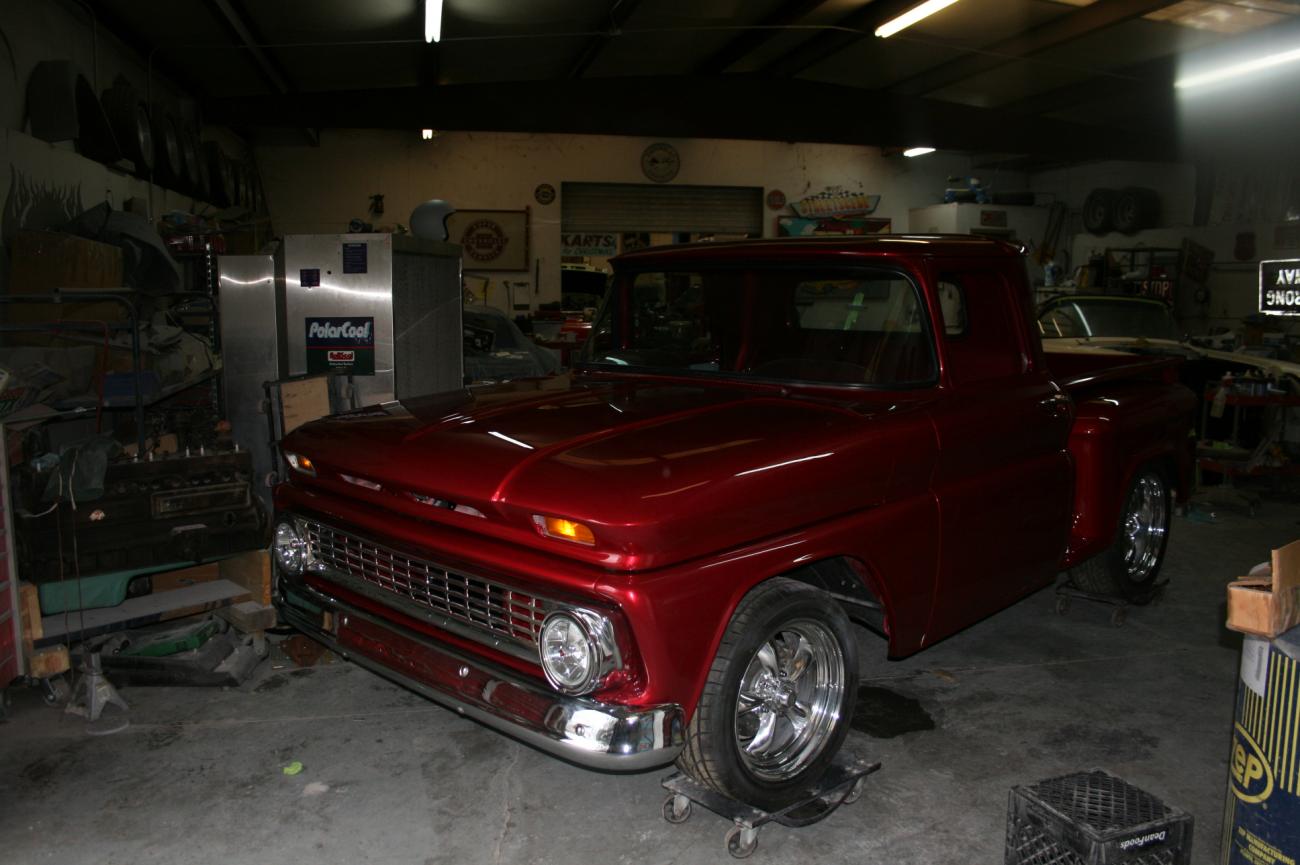

Update 3-3-11 Body panels are going back on for the final time which is a good thing. Of course we ran into a snag. Once the bed was installed the rear of the truck just didn't look right with the roll pan on it, so I decided to put the rear bumper on it since I had already bought a new one.
WELLLL that didn't look to good either, turns out that once you shave the front bumper and suck it up to the body that you need to do the same to teh rear, the front bumper is straight, the rear bumper is curved. SO the we decided to put the roll pan and the bumper on it just to see how that looked.
The look was better but still the curved rear bumper did not look so good on the back of the truck. Well months back he had bought a parts truck just in case we might need something we couldn't buy but it was a fleetside truck, well that time had come. A fleet side rear bumper is straight the problem is that the ends of a fleetside bumper do not have the curved ends to wrap around the rear fender like the original look which will still look funny :(. The problem is that the rear bumper has a profile and if you try to make something you have to have the exact same profile, luckily the front bumper on the fleetside has the exact same profile but has the curved ends, the rear bumber has the step in the middle of the bumper.
So what they did was take the center section off the rear bumper of a 1963 fleetside truck, take the end sections off the front bumper of a 1963 fleetside truck and mate them together. The bumper was shortened about 2 inches to makes it fit correctly, then the brackets were shortened so that the bumper could be sucked up to the body like the front.
A lot of trial and error yesterday but the results were amazing and I was actually impressed when he sent me a picture of the tacked up version last night about 9:00 pm.
They are going to TIG weld it today, grind, sand, polish and whatever else they have to do to get it ready to have it chromed. Send it out tomorrow to the chrome plater and it should be back Monday, maybe sooner. I was kinda skeptical about that time line since chrome shops are usually really slow and take weeks but since this shop sends him so much business he is going to do a quick turn around and get it back
But all the body should be assembled by tomorrow afternoon, everything re-cleared and polished and next week the mehcanicals completed.
Here is a picture of the last mock up look that he sent me so I could see how it would look with the curved ends. Very crude, I show this so when you see the finished product you will be impressed.

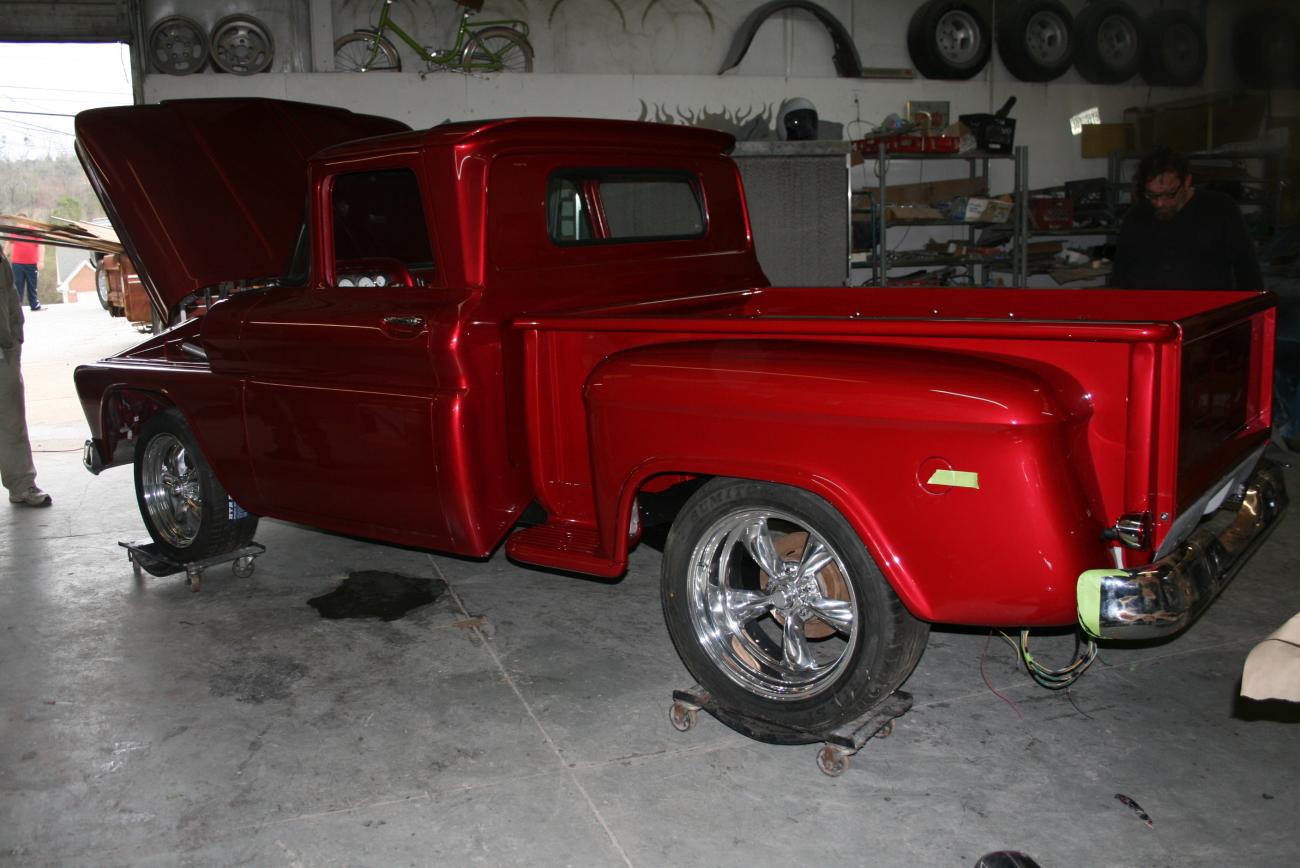

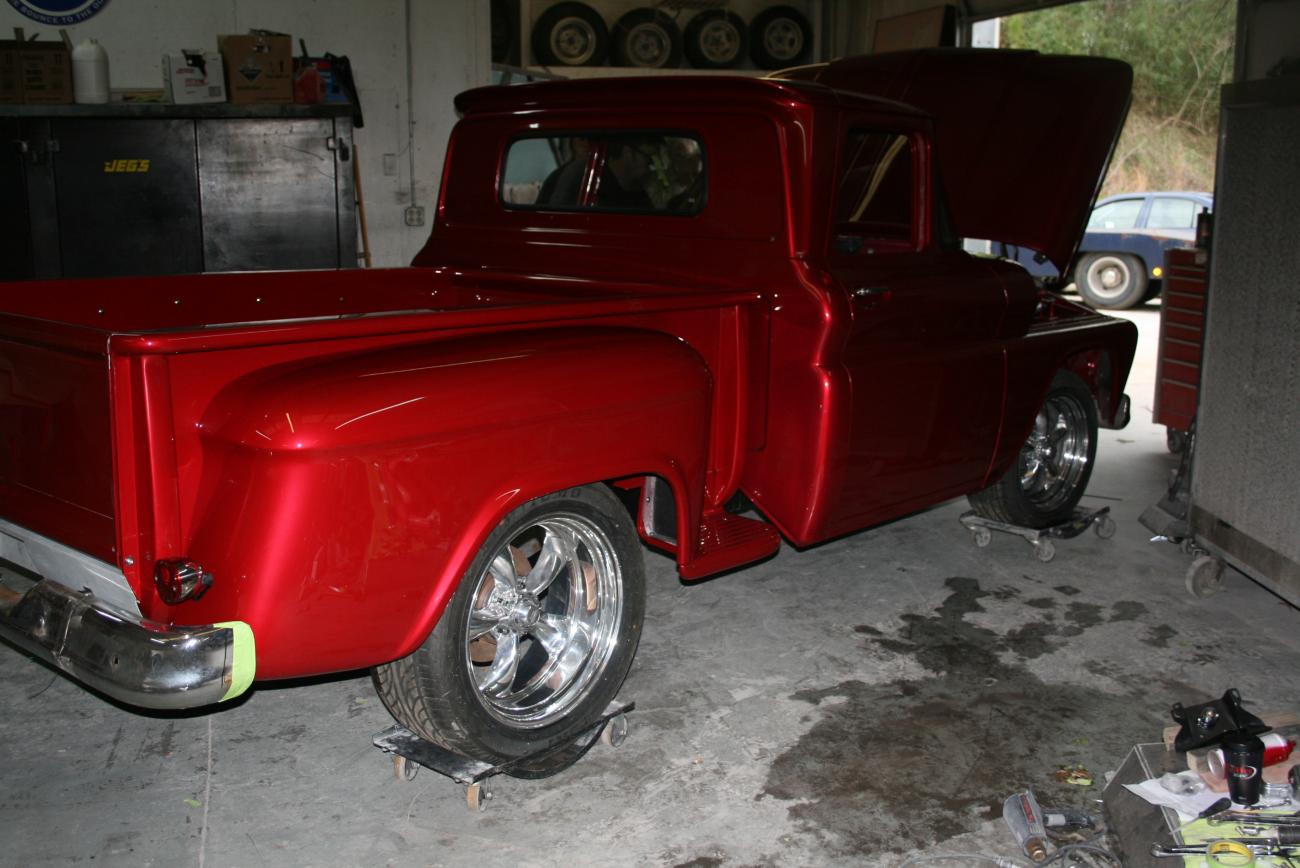

Sunday March 6 2011 Update.
Well My Friday visit has came and went.
To say my patience is wearing thin would be an understatement at this point. I fianlly decided to take my Uncle and little boy Drew with me so they could see what I have been talking about for years.
Of course my little boy was excited but my Uncle and I were a little more down to earth with our observations. The truck was together in appearance which you will be able to see in the few pictures I took, but pictures can be deceiving if you take them at face value.
Since this is 4 days past the deadline my tolerance for BS is very limited and my " Niceness" is very limited. Whle the truck appeared to be assembled it was only eye candy since the bed was just sat on the frame and held down by 2 of the 8 bolts.
I counted nine places that are going to need touching up with paint which is the whole reason I thought they took it apart on Feb 25 to re-clear and fix some things.
So to say there is alot of work to be done in an understatement, wiring needs to be done, brake lines need to be ran, motor still needs to be fired up and checked and then the interior needs to be installed.
I guess I have to decide on my next course of action and see what my options are at this point. I was sure hoping that it would not come down to this but it looks like I will have to spend more money to get this hing completed, this time paying lawyers.
But at least I got to see what it is supposed to look like.
The back bumper issue has been fixed,had to take a rear bumper of a fleetside 63 with the ends off the front of a 63 and mate them together.
