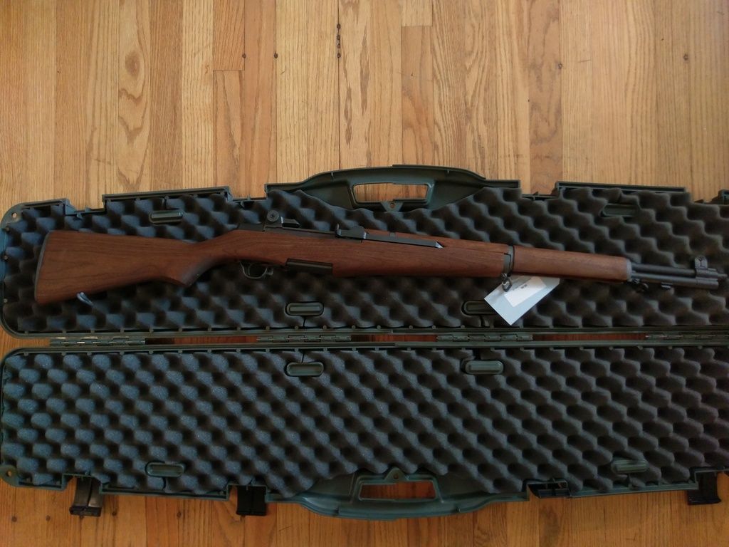

I am hoping to make a range day of either Tuesday or Wednesday. Got a new toy yesterday. Very

Posts: 2,258
Yippee!
Nice rifle, congrats.

I got the Special Field grade. It's got a very small amount of pitting. All-in-all, it's a freaking gorgeous rifle with a new Criterion barrel. It will outlast me, that's for sure.

Beautiful rifle! Range photos and vids are always nice to see
