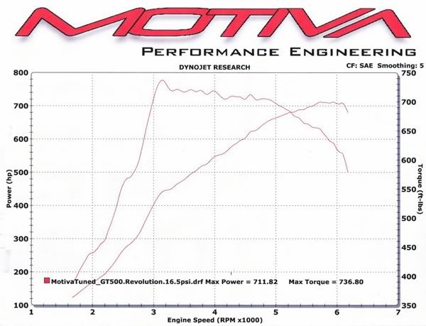

Here's the dyno sheet of a 2008 GT500 that has the same setup as I am putting on my car:
I have not heard of any overheating issues. Not only does the system use the factory intercooler, but it also comes with a second air-to-water intercooler to help keep temps down. I'd be more concerned with blowing out the seals of the blower at high boost levels than I would be things getting cooked.

Very nice dyno chart. Once you hit 3K rpm, LOOK OUT !!
