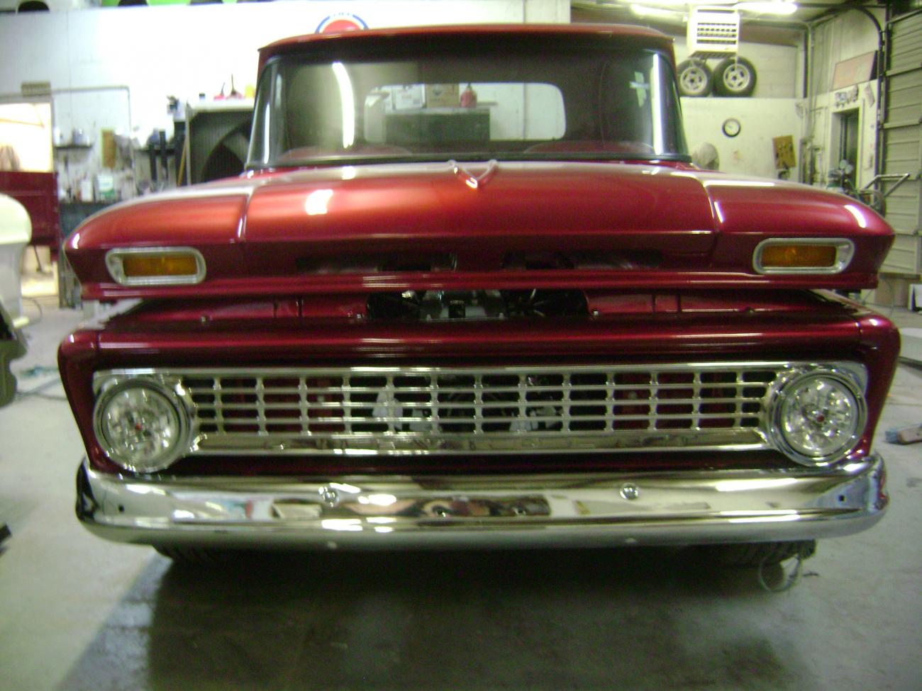

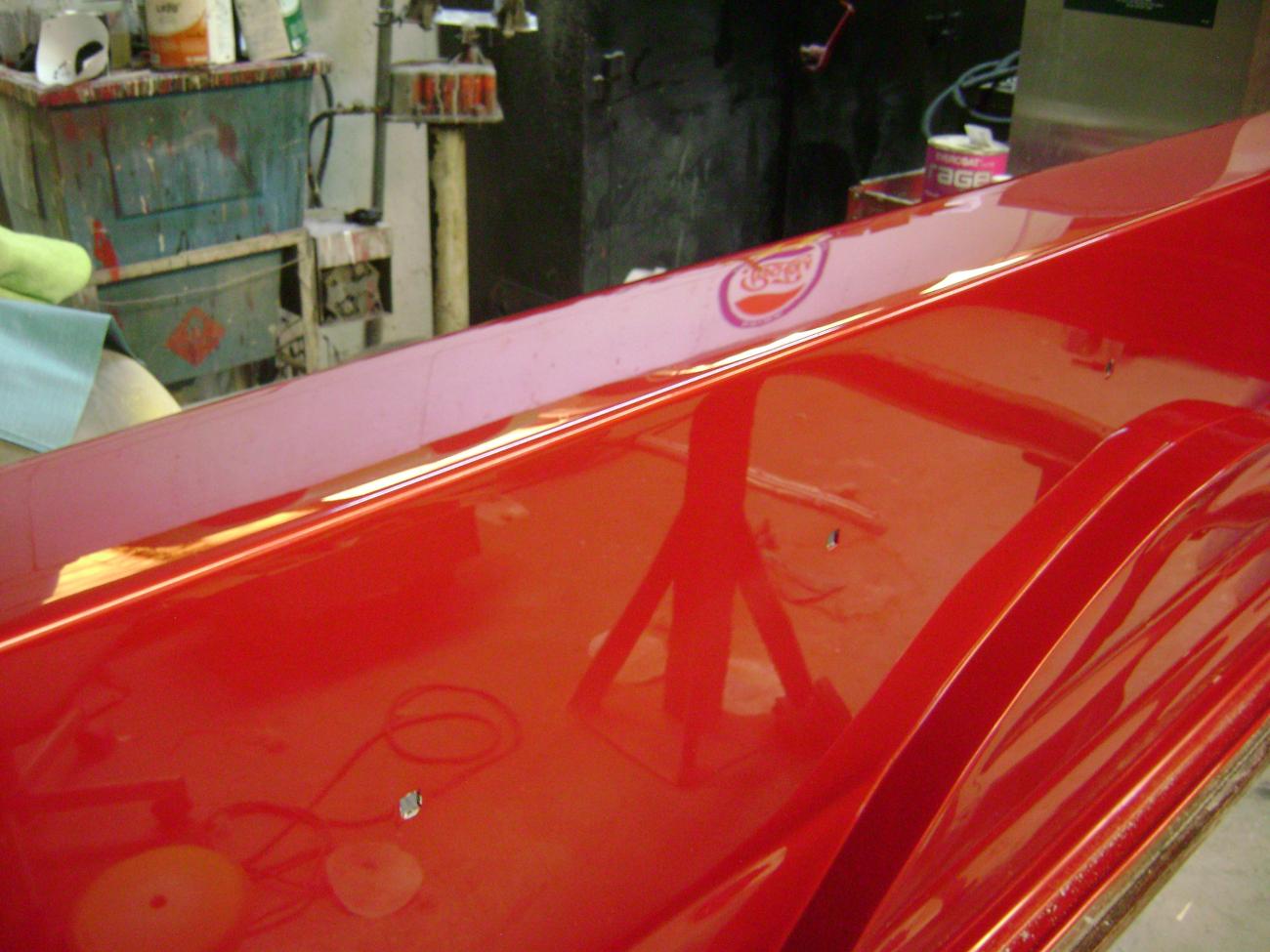

Update 2-11-11
Hello All,
Well another Friday has come and gone and the weekly check of Mr Hyde has been conducted. The bed has been buffed, the wiring is STILL going on but parts are going on the truck. The A/C is being installed and wired. The front bumper was installed along with the new headlights. The bed cross members were painted. Electric antennea installed and wired. Alot of little stuff.
17 days left looks like they need to pick up the pac but once again I have been reassured that he deadline will be met.
Here are a few pictures from today. If you notice on the front bumper I had the mount shaved so that the front bumper would be sucked up closer to the body, just a suttle touch.

Is that the original grill and bumper? Man, that thing looks sweet. I don't see any orange peel in the bed, excellent work!

This is actually the original grille and bumper off the truck.. It is not show quality because it was been done so long ago. There are some minor imperfections in each piece but you have to know they are there.

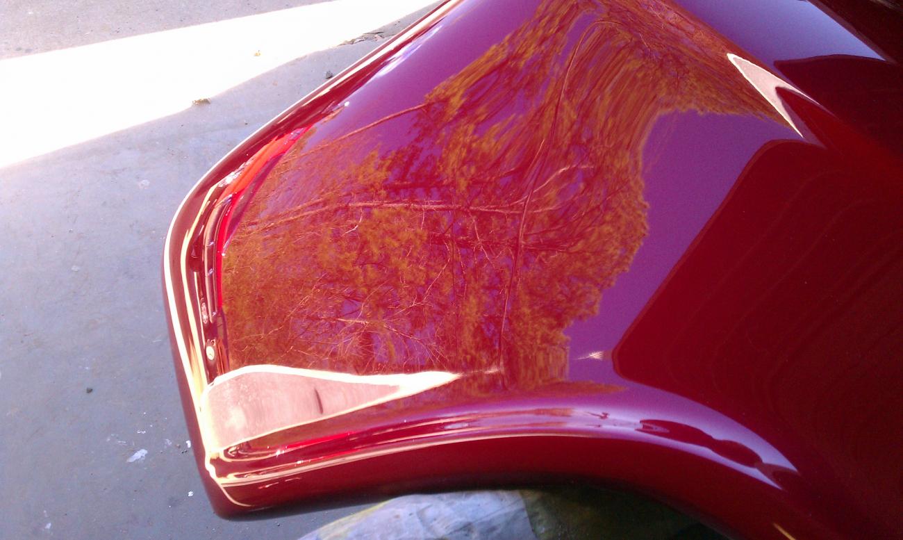

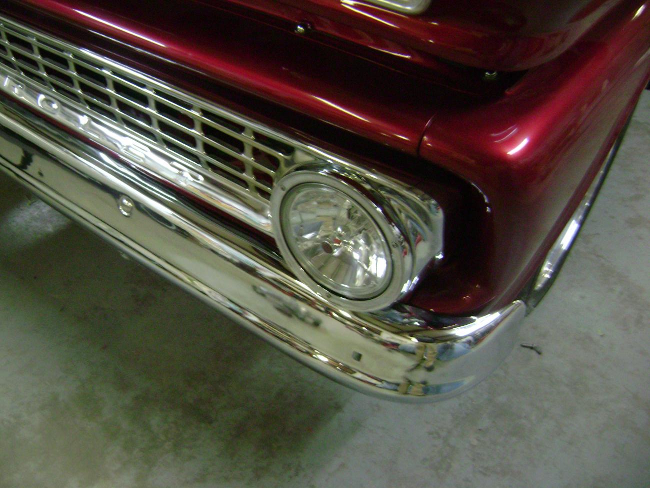

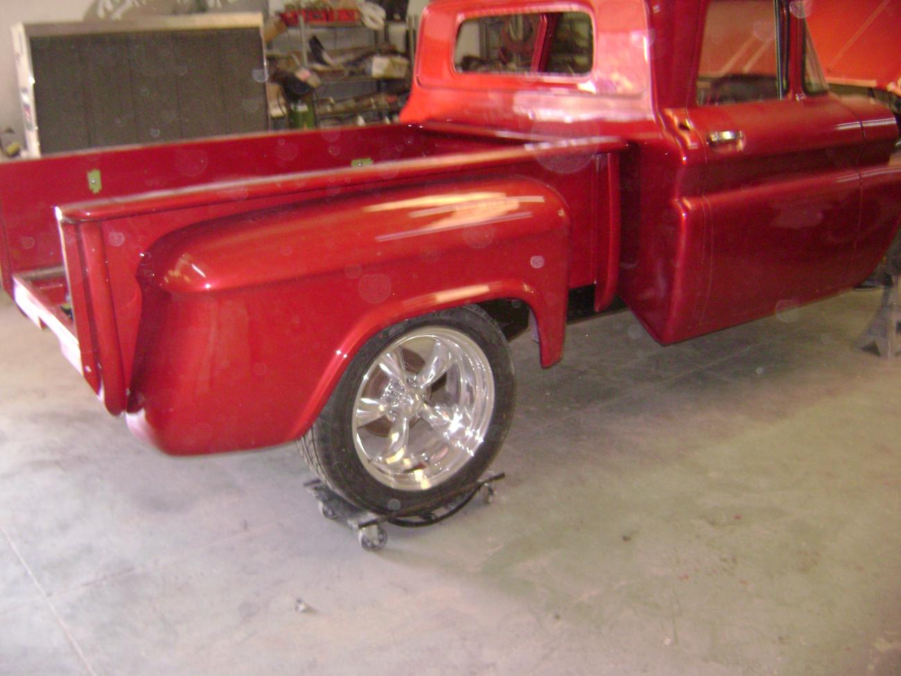

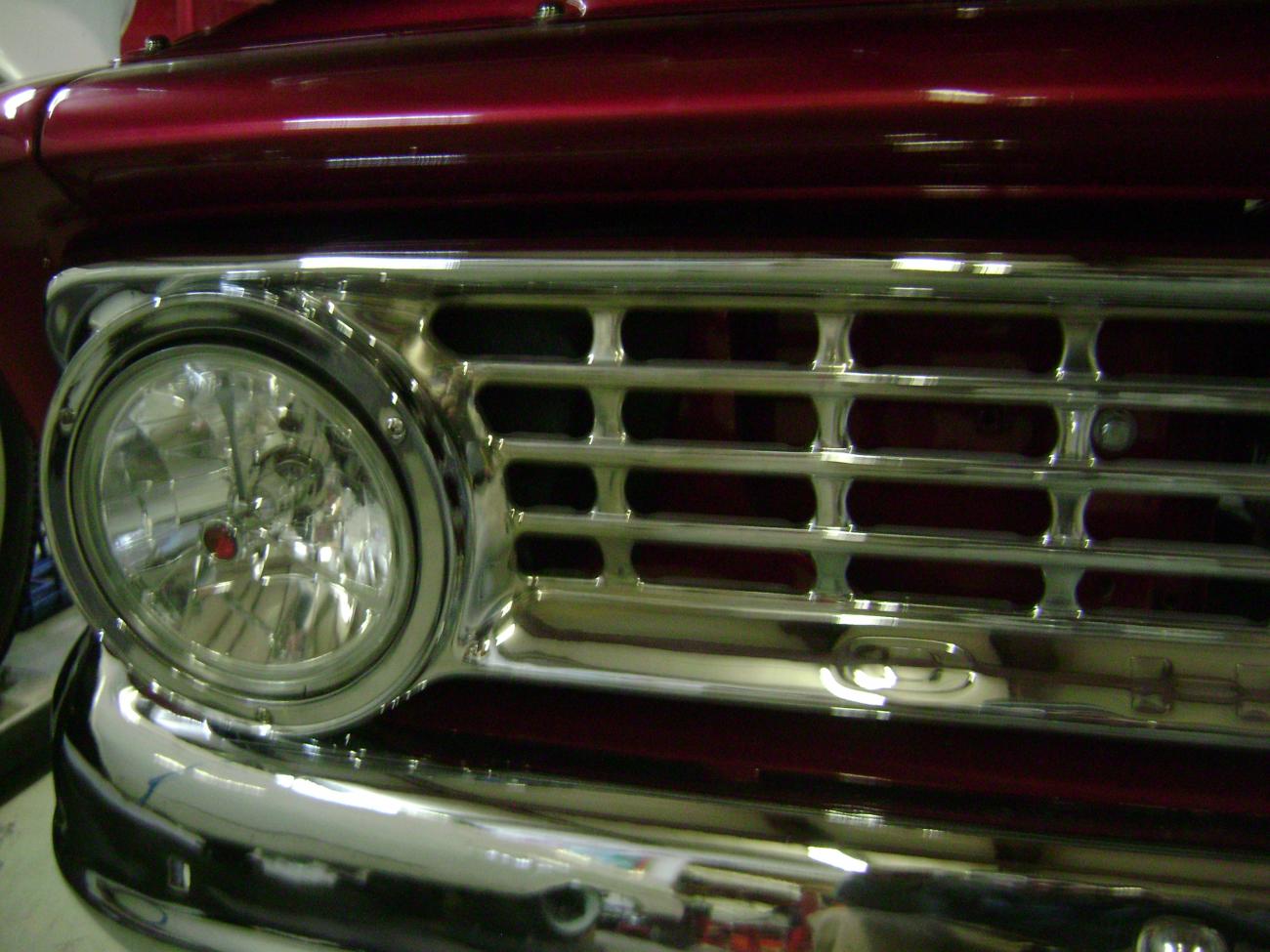

Weekly Update 2-17-11
Yes I know today is Thursday, but I had a doctors appointment in Birmingham, had to take my boat to be serviced and after putting 75.00 worth of diesel in my truck I figured that one trip to Birmingham a week was enough. Diesel was 3.55 a gallon
ANYWAY we are 11 days away from D-day. I made my weekly trip to see how things were going and how much progress had taken place since last week. It was actually funny since I was a day early and they weren't expecting me. They were kinda shocked to see me.
Alot of progress has been made, but I still don't see how they are going to be finished in 11 days, maybe they will surprise me. I guess only time will tell at this point.
After seeing the bed together I decided to go back to the original way and not put the rol pan on it and have a rear bumper and real tail lights instead of frenched in LED lights because it just didn't look right.
The header issues were worked out, , and the engine should be running on Monday so they can work out the kinks on it, so basically all they have to do is assemble it. They have one area that still needs to be addressed on the paint and body but it is minor.
I told them that next Friday, Feb 25, 2011 that I will arrive with blue painters tape and identify areas that I see that need to be addressed and that I want fixed, that should be really interesting to say the least, this way it will give them the weekend and all day Monday to correct the areas that I identify.
So here's a few more pictures for you to enjoy.

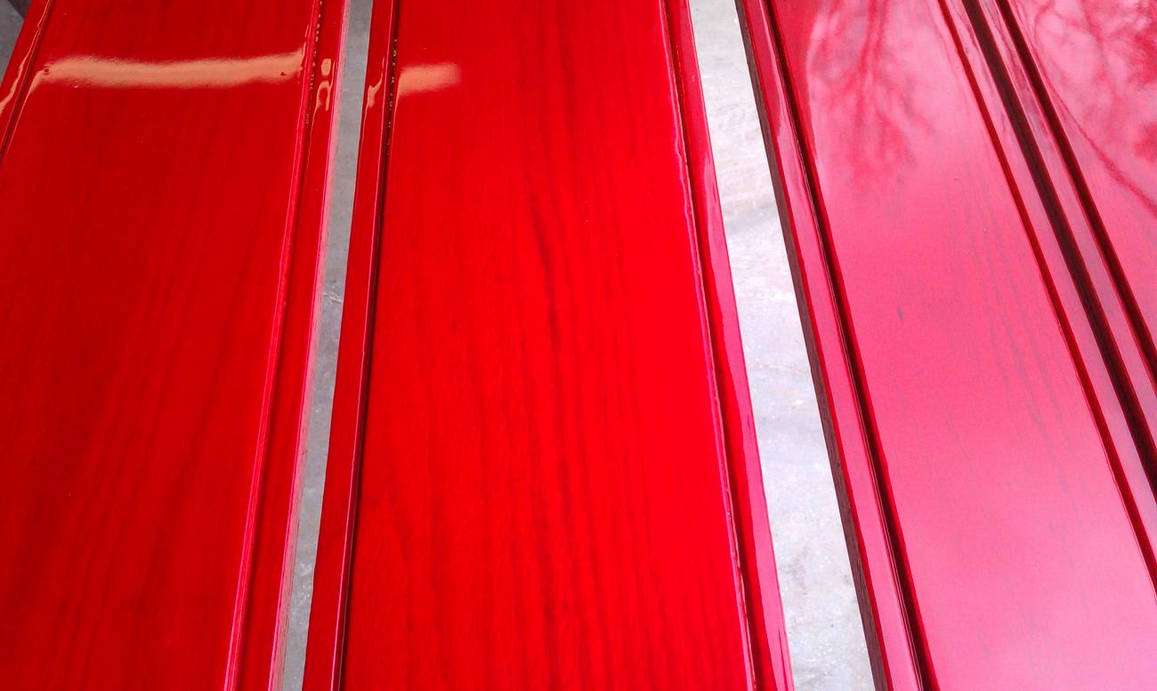

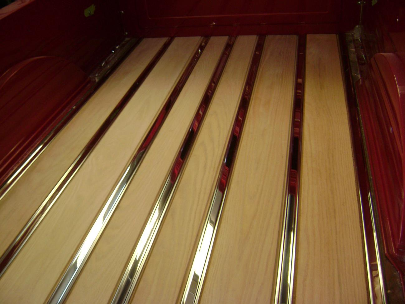

A little more on the progress, here is a sneal peak of the bed wood. I had it tinted to match.

That's pretty neat. Tinted? Is it a stain?
Actually it is neither. I said tinted but what it really is, is paint. What was done was this. Since Oak is very pourous wood the grain had to be filled in, so it was filled in with car clear to a certain point, just a cheap clear. Once the wood was smooth then the body paint was added to the clear and mixed to give it a transparent look so that you could still see the grain of the wood.
On top of that it will have three coats of clear so that it can be cut and buffed just like the rest of the truck. The pictures were just out of the paint booth and still have to be sanded then the clear applied then cut and buffed to a mirror shine.
