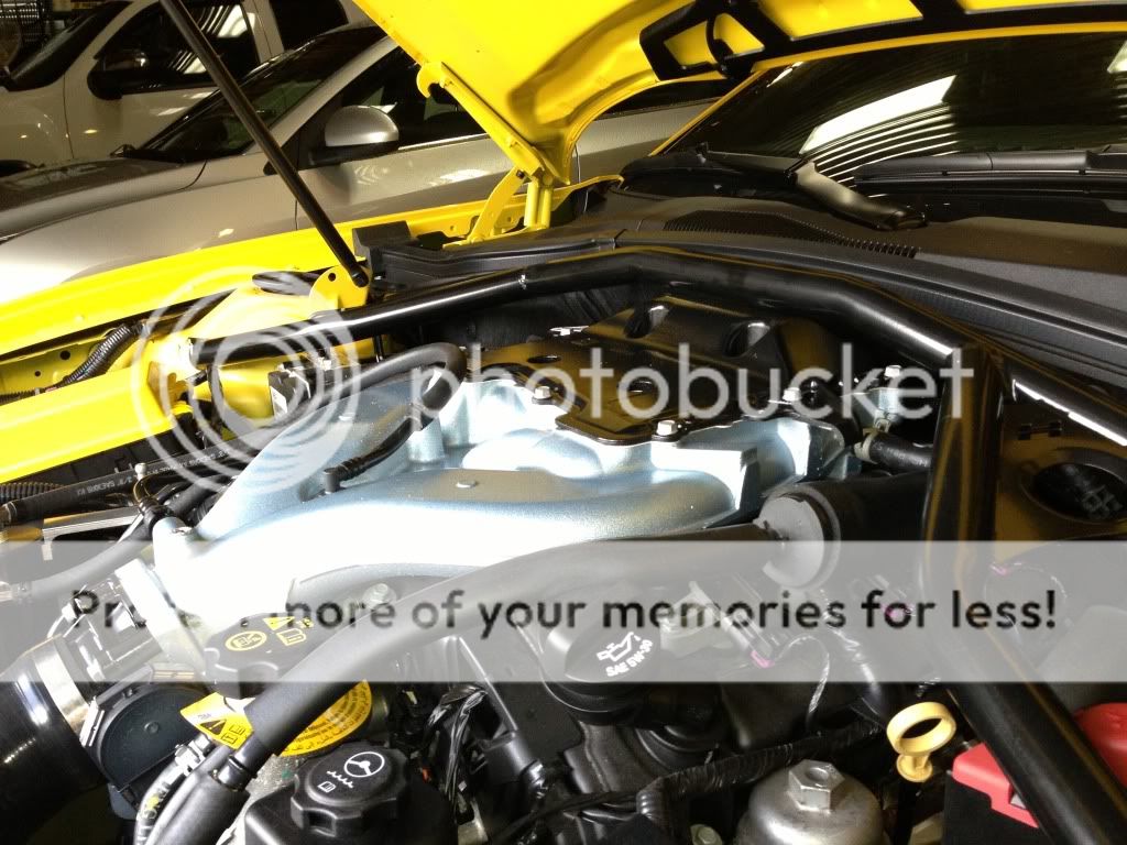

Originally Posted by Botoasy View Post
Alright so I have a question that I cannot find any info for on this forum. I have the mace 25mm spacer, and now I want to put an aftermarket strut tower brace on my car. Now it is a 2010 so no GM factory one for me. My ultimate question is, will a strut brace be able to clear the intake manifold?
Depends on the bar. I have the hotchkis bar and love it. Since the GM one wouldn't work it was my second favorite and have been happy with it. But I can guarantee you this one WILL NOT fit over the 25 MM spacer. I don't have a spacer and my clearance is minimal only about half am inch before the plenum cover. That pretty much leaves you with the BMR bar and on that one I'm not sure I never really considered it since I'm not a fan. Also there is the Pfadt bar but I'm not 100% sure if its designed with the V6 in mind.

Posts: 9,686
looking at pictures, I don't see any reason for any brace not to fit with a 25mm spacer.
You can see It on this picture. I don't have any spacers and this is with the Hotckis bar. If I remember correctly a member here had to get rid of his BMR bar to fit the 3/8 inch spacer and plenum spacer.
Old 07-23-2013, 03:18 PM   #6208
Posts: 57,201
damn...yeah, if they would have designed the bar to not go over the plenum cover...that sucks. seems a GM type design is all you can do, if you have a spacer.
