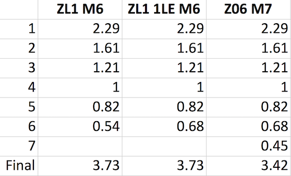

I don't know about a "gimmick", there's no doubt it helps with FE...here's a comparison of ZL1, ZL1 1LE, and Z06. They're each identical up through 5th gear. So they had to give up the FE gear in the ZL1 1LE to hit top speed...but the M7 lets the Corvette have both.
Name:  Screen Shot 2.png

In the heavier Camaro you'd probably spec a somewhat different gearset from any of the Corvette's. Per Tremec's own site,
Alternative ratios available upon request; may result in different maximum input torque
Norm
Attachment 916325
Add a 3.91 like the Z/28... I’ll take a lower top speed.

Originally Posted by SS 1LE View Post
All it is in the C7 is a TR-6060, with one more overdrive, same ratios otherwise.
That doesn't make the 7-speed a bad idea. More like a decent idea with less than satisfactory execution. A different gearset with perhaps a slightly taller final drive. Like maybe start by exchanging that 0.45 7th for a 3-ish 1st. As it sits, the overall gearing in 1st (7.8:1) is more like a 2nd gear and definitely a bit on the tall side for easy street driving in traffic. Let alone standing-start drag racing.
The time I drove a 7-speed Z51 - on a road course - I didn't find any difficulty with the widths of the gates. Is that mostly a complaint from the drag racers?
