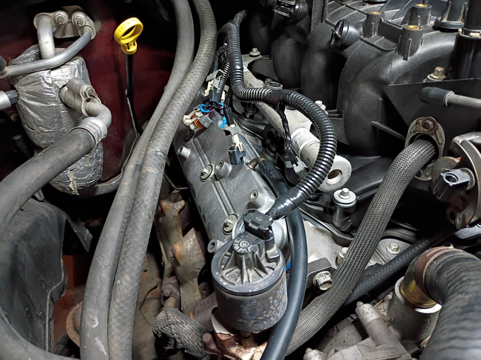

So after test fitting the catch can in a few different spots around the engine bay, I settled on this large hole behind the left headlight, beside the battery tray. My lines will be long but it's ok, I've got plenty of hose and I've got some ideas on making them look presentable.
While there is ample room to run lines and get my hand down there to unscrew/service the can, there is one caveat: the mounting surface for the can bracket is the plastic headlight support core. This plastic is some thick stuff but this can is not light. I'm concerned about cracking the support from vibration. IMO it needs to be reinforced.
There are 2 holes in the plastic for clips that are perfect for some 1/4" bolts. I picked up some pre drilled flat stock from Ace which just happened to be the perfect width. I cut them to length, wallowed the two bottom holes as the distance between holes wasn't exactly the same as the truck. The design is to sandwich the plastic support. This (in theory) should brace the plastic and distribute out any twisting from the weight of the can. I'll take these in to work and give them the same semi gloss black treatment as the battery tray, once it's all installed, you shouldn't even be able to see it through the grille.
I could have this all installed within the next few days if it weren't for my catch can fittings being held up by the supplier and the Chinese new year, which I could go on a whole rant on but I digress. I did secure the later model fuel rail setup with the stainless steel crossover tube, just waiting for it to ship out from the dismantler. Replacement O ring kit is already on hand. Once I get this fuel system and catch can setup done, the rest is just reassembly.

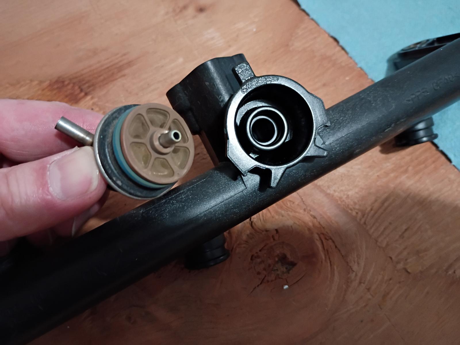

Finally got my replacement fuel rail assembly in. How you see it is how I received it, these are definitely 2 rails off 2 different trucks but it really doesn't matter. They match physically and the most important part, they don't make any noise when you shake them. The originals off my truck sound like maracas. This should fix the EERRRRR noise.
The real point of this was the stainless crossover tube, which was definitely worth it. When I disassembled the original, you can see the mild steel tube was starting to corrode on the lip and puddling around the edge of the fuel rail inlet, again, this isn't helping. I cleaned and hand polished the aluminum replacement which should last the rest of the life of the truck.
I broke the rails down and cleaned them up. They came with injectors but no fuel pressure regulator, no big deal mine seemed to be working just fine before teardown. Unfortunately, when I pulled mine off the old rail I quickly realized GM changed the design when they moved over to this new stainless steel tube. This rail takes a regulator with a thicker input shaft.
I have a new Delphi on order that I think should work with this rail, should be here tomorrow and I can continue re-assembly. I did start setting things in place on the passenger side, nothing is tight just in case I need to pull it back apart. Short of an unforeseen issue, I should be able to get this thing back together this week and maybe test run over the weekend.
