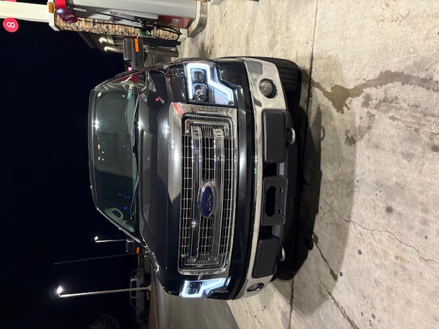

Post Update and wondering if you folks could help me out with a calculation. Bought a 2014 F-150 5.0 4x4 and I'm trying to figure out if the numbers say I can tow or not? If I can't tow I'm still happy with it as my new daily but I keep reading conflicting info about payload needing to be subtracted from tow capacity. It has the factory tow package with the larger radiator, trans cooler and class V receiver.
Truck numbers:
Tow Capacity: 7800
Payload: 1644 (includes full tank of gas)
Trailer Weight + car + wheels = 6,060 lbs. let's say tongue weight is 900 lbs which is on the high end.
Tonneau cover + weight distribution hitch = 175 lbs
Me, wife and dog = 315 lbs
Jack + tools + Ramps = 180 lbs
misc = 50 lbs.
This puts me just below my payload max at roughly 1630. Now this is with calculating the tongue weight on the high end.
Now my question is am I supposed to add payload to trailer weight? If I am I understand that I don't add the 900 lbs for tongue weight to "trailer weight" because I'd be double adding. So I'd only be adding 730 lbs to 6060 lbs. Is 6790 my total trailer weight even though 730 lbs of it is not actually in the trailer?
Basically I'm trying to figure out if I can safely tow this amount with the listed payload. I know you should stay at 80% or below your max tow capacity. If I only need to worry about the actual loaded trailer weight then I am good because 6100/7800 = 78%. If I need to include my payload in the actual truck then I am not good. Any help is appreciated. Thank you!

Think of Payload as anything that loads the suspension of the truck, so you count the tongue weight.
Tow Capacity is the weight that the truck has to pull and stop so you count all of the weight of the load, trailer and anything added to the truck. But you don't add in tongue weight.
Yep, that's how I got to 1,630 lbs for payload.
So this is where I think I miscalculated. I didn't think the payload (minus tongue weight) counted towards the tow capacity. That would be the 730 lbs of people, animals, accessories, tools and wheels. That puts me at 6,790 lbs at 87% of my tow capacity.
My total GCWR will be at 12,490 lbs. Legally I am allowed to do this as the manual shows 13,500 lbs if I am remembering correctly. I am guessing it's not smart to be within 1000 lbs of that max number. I would feel better about it if I added 3.73's and bigger brakes but this high number would only be towed one time.
I think this truck will work for me when I go to far away tracks by myself, with no tools and accessories other than the tonneau cover, WD Hitch, Myself, breaker bar/socket/torque wrench/tire plug kit/, ramps and misc (can borrow a jack from someone at the track usually incase of a flat). All of that will put me right at 80%. Maybe a hair above.

Legally, there are 2 stickers on the door jamb and if you get inspected you had better be within those limits. Be it ticketing or insurance.
No forum, manual, website, or otherwise will matter.
Yeah I’d be within those limits.
Tire loading sticker shows 1,644 lbs for payload. GVWR is listed at 7,350. With what I have calculated I’d be within those limits and that’s with calculating tongue weight at 15% to be safe. Let me know if I’m misunderstanding you. Correct me if I’m wrong but I think GCWR matters too right? That had to come from the manual, not the stickers. Max number is 13,500 lbs.
Correct me if I’m wrong but to get curb weight it’d take the listed on the sticker GVWR of 7,350 minus the 1,644 number on the tire loading sticker which equals 5706.
Loaded trailer is 6,060. Cargo INCLUDING truck accessories equals 730.tongue weight = 900 lbs. 900+730 = 1630. 1,630+5706 =7,336 and that’s with calculating tongue weight at 15%. 7,336+6060-900=12,496. So about 1k under the GCWR.
Just wanted to know if I can safely stop the vehicle. Seems like the 80% rule is more of a longevity rule for parts on the truck. At least that’s what I was told of inquiring about this with folks. Towing capacity is 7,800. Loaded trailer + cargo puts me at 87% towing capacity. This amount of cargo would literally be a one time trip for me. Every other time I’ll be right at 80%.
