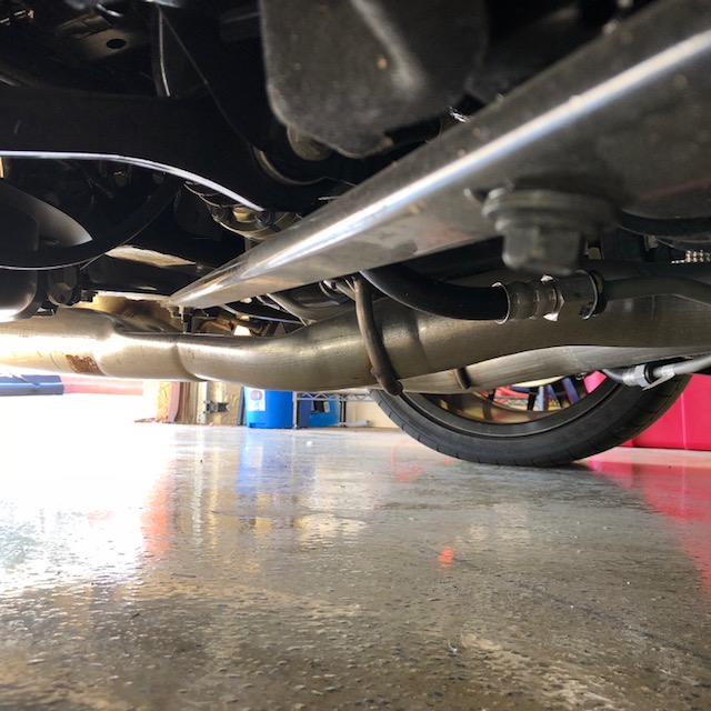

Crimping provides about an 1" of clearance from 'vert cross brace on my ZL1.
This pretty much confirms Chris V's post, and answers my question.
Thanks for the pictures!
