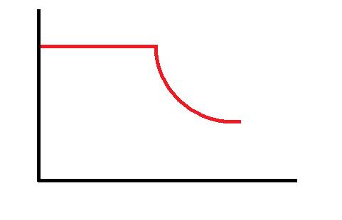

Also, we've all seen horsepower/torque graphs for gas engines, but have you ever seen one for an electric car? What does that look like? Most of them I have read about are rated for peak torque at 0 RPM, but how fast is the drop-off as speed increases? And is the RPM on such a graph the speed of the motor, or the speed after gear reduction?

It varies. Different electric motor types have different characteristics and the shape of the curve can be manipulated by the maximum current allowed by the controller. In its most basic form, the torque 'curve' for an electric motor is a straight line with a maximum at 0 rpm and constantly declining until it reaches 0 at maximum revs. Others look sorta like a rectangle with a 1/4 circle taken out of them in the upper right corner. They'll maintain maximum torque for a while then drop off sharply but as rpms continue to increase, the drop off rate slows down. Ummm ... it looks like this:
Name:  Torque Curve.jpg
The speed and torque on the graph would most likely be after the gear reduction, but I can't say for certain and if there isn't any sort of standard for advertising these numbers, it could easily switch from one manufacturer to the next.
