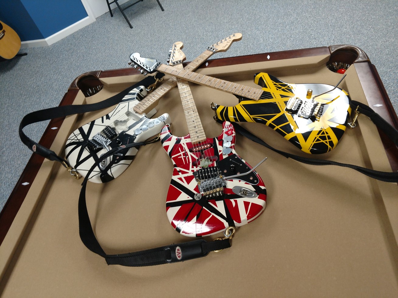

My VH "tributes"...I say tribute as while they have a strong resemblance to the actual guitars, they are by no means exact replicas, not intended to be as they are built to my preferences. Also, no relicing, these will relic naturally when I play the heck out of them! So the B&Y is named "Bee", the W&B is named "Frankie" and the RB&W is "Frankie 2"

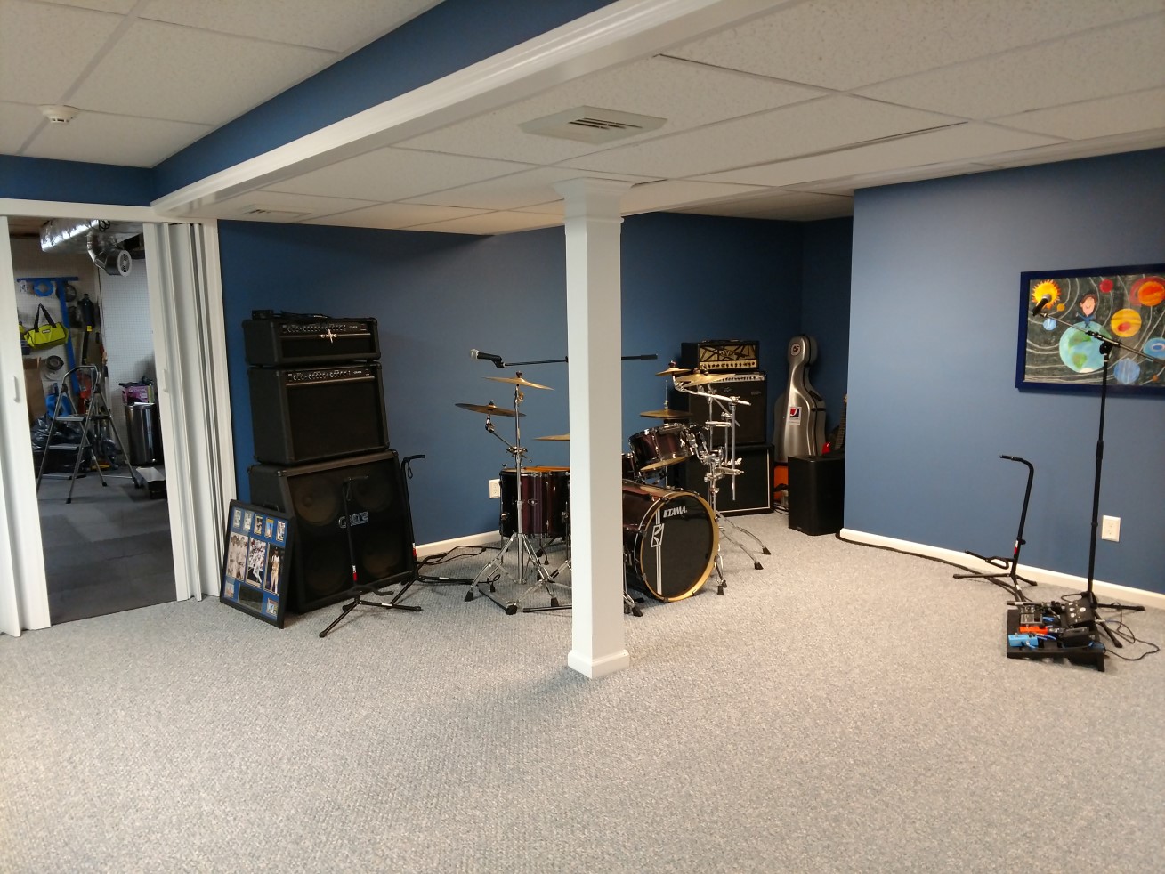

Finally, a view of my downstairs "studio" space and some other assorted gear and such! And of course walls of guitars (not all built, some bought of course!)
Oh, the black ES-335 type is for my GF's other daughter, her and I are building that one together, she is 17 and is getting her feet wet on building, pretty challenging to take on for a first time, but she does have help!
Yes, that is a Cello back there also, daughter number 1 is classically trained, Julliard, the whole thing, now she jams an Orange ES type! She plays like everything though....Ido have other guitars and more pics, but will have to dig them up...eventually

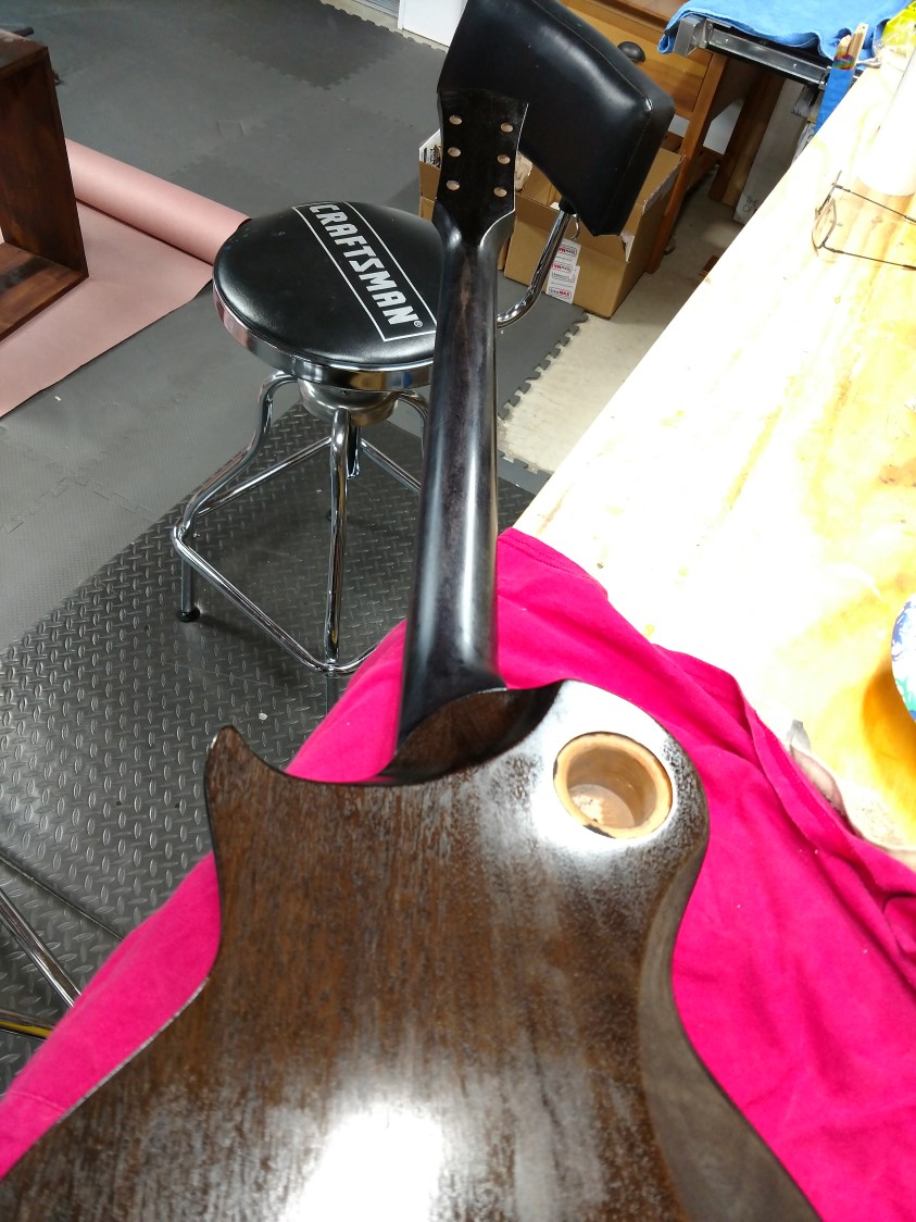

OK, so the LP I am currently working on, this is again hand rubbed dye and I am working on the coats of Tru Oil for this one, so Tru Oil looks like this!
Back is at about 7-8 coats....front is about 12 and the neck, I never use more than 2-3 on the neck as I want it thin and satin, again feels almost like super smooth raw wood. This is just Tru Oil, no buffing, wet sanding or polishing yet.....

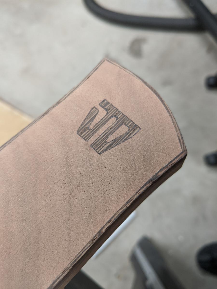

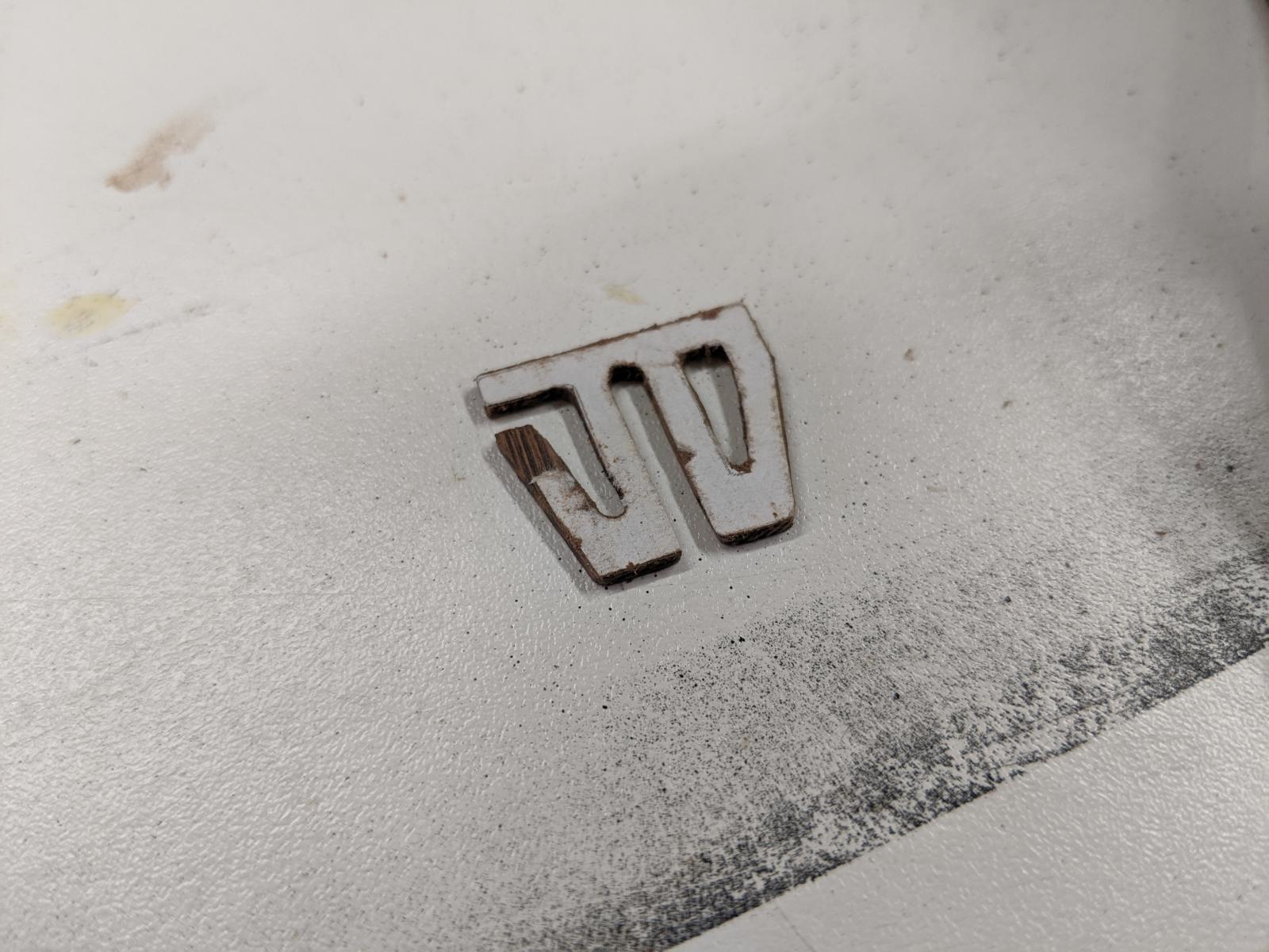

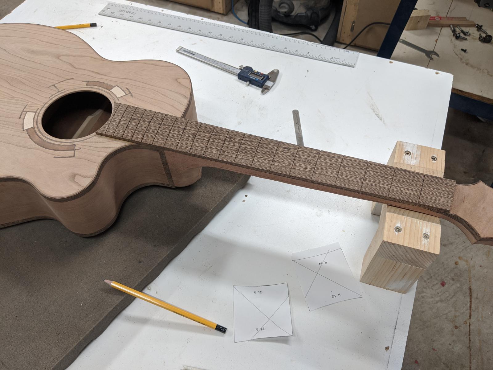

Thanks! It's my first one, and with the amount of challenges I've given myself, I am really happy with how it is coming out. For sure there are some imperfections but I learning which is the most important.
I've completed the logo on the head and glued the fretboard.

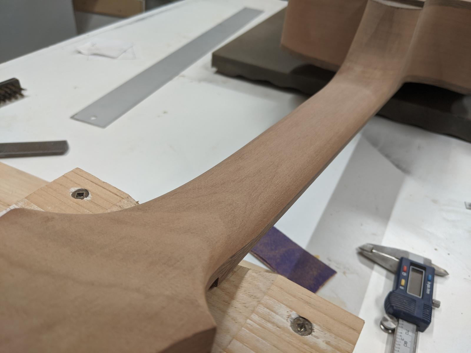

Neck carved and fretboard radius completed!

Looking great! I hear ya on imperfections, all of mine have a wart or two, that's ok with me. What matters is, how it plays, how it feels and how it sounds. I play them so much they would only be perfect for a short time anyway! lol I tend to naturally relic a guitar pretty quickly.
The journey of the build, the pride when completed and the sheer joy of playing something YOU made is something you can't put a value on, it is priceless! Looking forward to the finished guitar!
