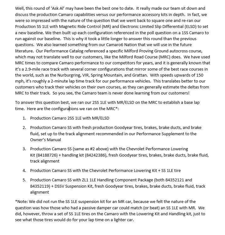

[ANSWERED] GM Suspension Kits on Camaro SS
Originally Posted by vtirocz View Post
Al,
I'm interested in upgrading the 1SS base suspension to be closer to the 1SS 1LE. Can we get some comparison data (lap times) and your thoughts to help make this decision, including any recommendations for OEM wheel/tire combination upgrades to work best with each kit.
Kits:
1. SS lowering kit (springs/shocks-84188726) + handling kit (swaybars/front links-84242386)
2. SS 1LE suspension kit with MRC cal update (not applicable to my specific car)
3. ZL1 1LE suspension kit (both 84352121 and 84352119)
I'm leaning toward this combination of parts to get as close as possible to an SS 1LE: SS lowering kit (springs/shocks-84188726) + handling kit (swaybars/front links-84242386) + SS 1LE wheels/tires
However, before making a final decision, I'm really interested in you and your team's thoughts and recommendations and what the performance #s would look like between the different options.
Existing literature states:
- SS lowering/handling kit (springs/shocks-84188726) + handling kit (swaybars/front links-84242386) provides a 1.6s lap time reduction on Milford Proving Grounds Autocross course.
- ZL1 1LE combo noted above provides a 1.8s lap time reduction at Milford Proving Ground NE course on an SS.
Answer:

Al & team: THANK YOU!!! This is exactly the level of detail I was hoping for and far beyond what I was expecting when I posted this question. I really appreciate you guys taking the time to provide actual lap time data to help make this decision.
Here's some things that stand out to me:
• The SS 1LE is 8.5s faster than the non-1LE on a ~2 minute course. WOW! I thought they would be much closer.
• The lowering/handling kit alone provides a much bigger benefit than I was expecting and gets you about 55% of the performance benefit of the 1LE package.
• The lowering/handling kit + SS 1LE wheel/tires get you about 77% of the performance of the 1LE package.
• I was expecting a much bigger benefit with the ZL1 1LE suspension kits on the road course. I guess you need the ZL1 1LE wheels/tires to reap the benefit of that stiff suspension setup. This also highlights that it's important to match the tires to the suspension tuning and that stiffer isn't always better (for a given tire choice).
The lowering/handling kit + SS 1LE wheel/tire seems like the sweet spot for what I’m looking for and would work perfectly in my goal of creating a "budget SS 1LE." Actually, the lowering/handling kit alone may be enough! Either way, it's nice to have data to make this decision. The lowering/handling kit combined goes for around $1500 depending on the vendor and SS 1LE (or similar) OEM wheels could be had for probably ~$1500-1800 used and $~2200 brand new if I remember correctly.
