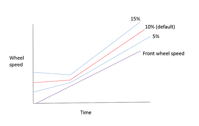

The custom launch control is best explained with a drawing:
The red line below is the target slip the system will control to. Then the 'modified' targets from 15% and 5% are shown.
Name:  targeted slip 2.png
