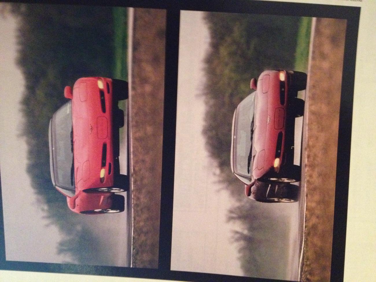

Old 09-30-2014, 09:46 PM   #14
SantaRay
SantaRay's Avatar
Drives: 2015's Conv. Z06 3LZ, & Z51, 3LTZ
Join Date: Sep 2014
Location: Orlando
Posts: 19
"shocking" Differnence
Look at the rear wheels. Same spot on the track, same speed, model etc... One with MSRC and one without. This picture is in the October edition of corvette magazine. I like flying, but I do not like being airborne in my Corvette! (I have no idea how to rotate the image. It did that when I uploaded it...)
