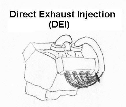

Originally Posted by MuscleCarz View Post
That's what I meant.
Hey that's cool. I just didn't want him trying to pipe exhaust gases into his new baby.

Posts: 194
MuscleCarz is offline
Old 07-14-2009, 11:20 PM   #12
coolman
Guest
Posts: 4,812
Hey new tecnology! Sell it to toyota or honda.
coolman is offline
