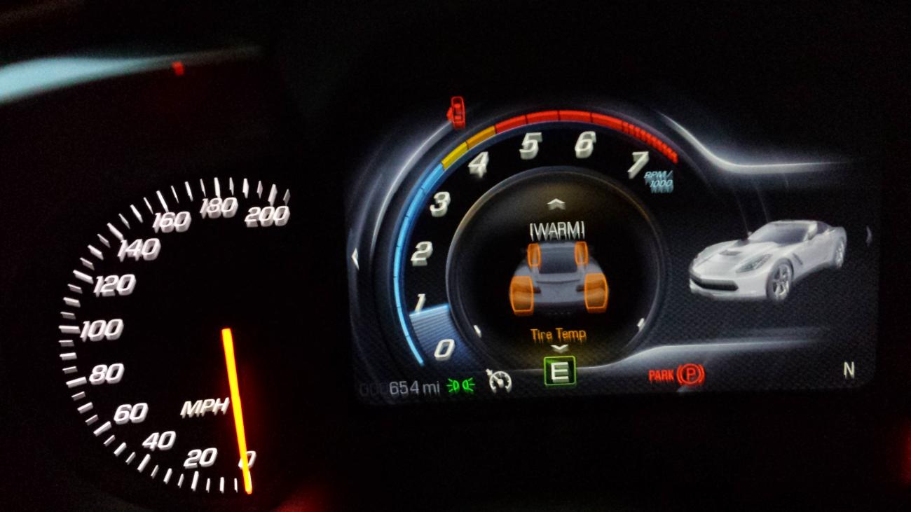

My Tire Temp monitor Doesnt Work
It always says warm no matter what LoL..
Pretty sure I goto the dealer they going to have no clue. and I dont want to leave it there forever so they can see it is cold after sitting over night..
Anyone else notice this on theirs?

This is when it should say warm

Based on several days of daily driving with cold mornings and warmer afternoons, it seems the cold/warm point is right around 40 degrees. This makes sense as the tires are not intended to be driven under 40. According to the owner's manual, "warm" indicates the temp range for normal driving conditions. I don't believe you're experiencing any kind of malfunction.

I did think the same, that it wasn't working, until it dropped below 40 here. Low and behold, "cold" showed up. And believe me, the tires don't grip well until they warm up a little. Do keep in mind, the sensors are for the tire temp, not the air temp. The display also isn't using just the tire temp from the sensors, but several other factors too, to show the overall state they are in. Per the manual, "hot" indicates ideal range for best track performance, not that the tire is dangerously overheated, etc.

Should say cold before freezing
