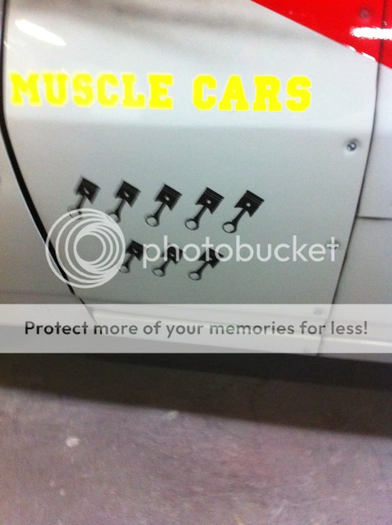

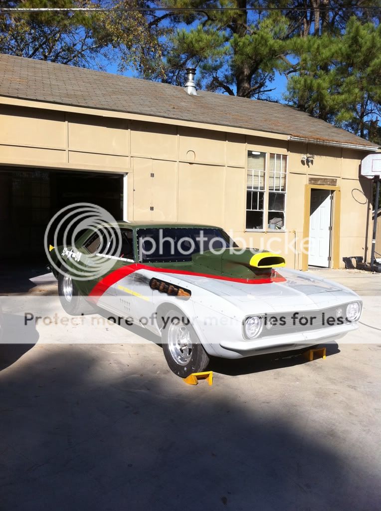

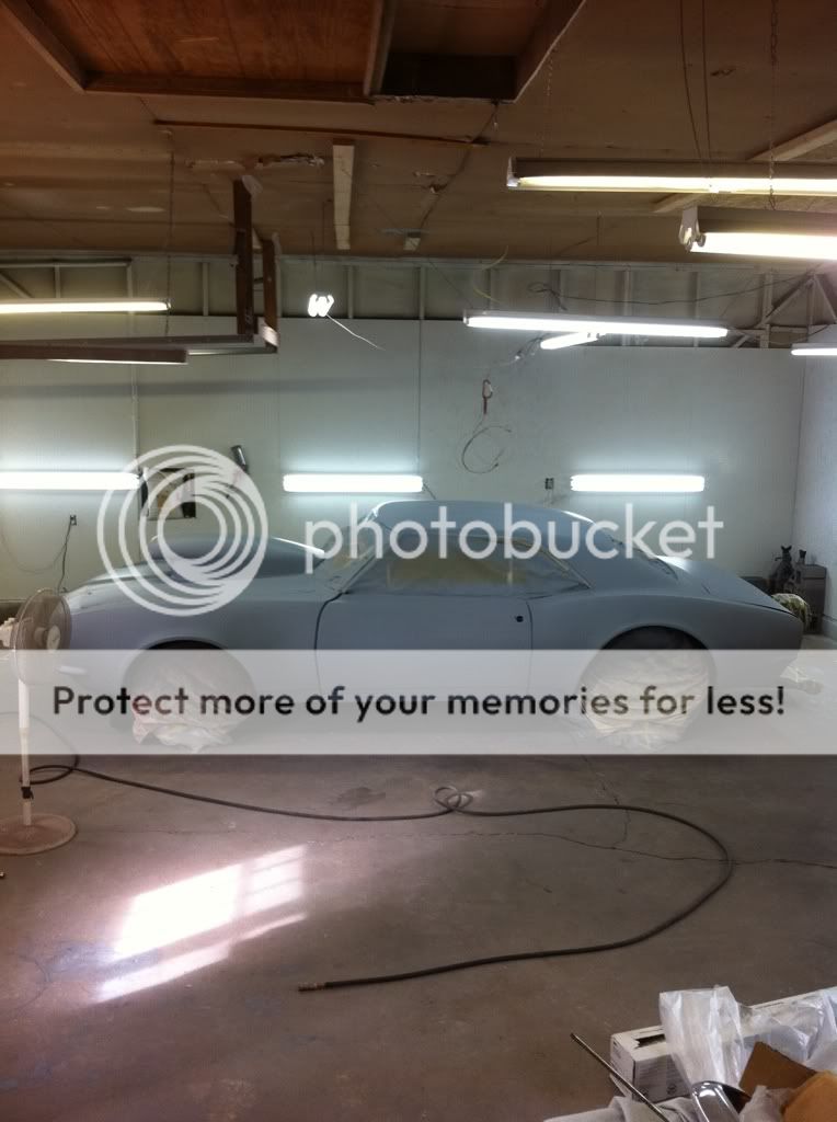

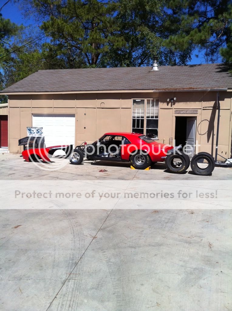

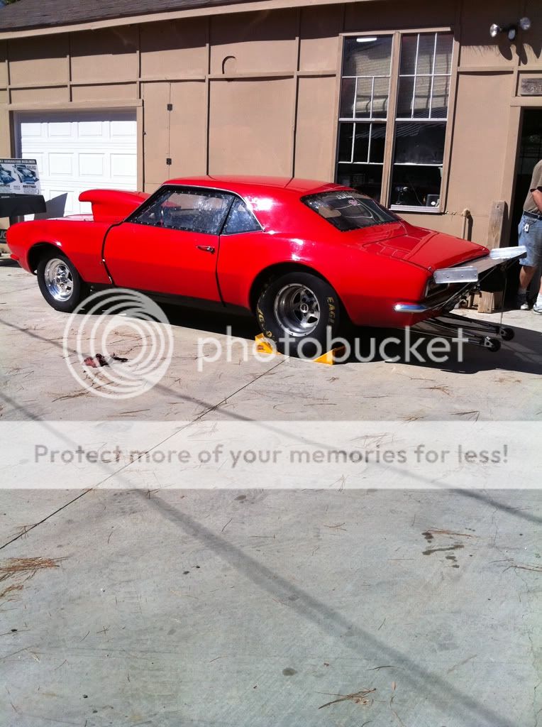

well a few months ago we decided to retire the 94 camaro and part it out and get a new drag car and this is what we came up with::turbonaug
car was a low low 9sec car with the SBC in it on 175 shot. it was one of many of a customers car and he decided he needed to thin out his drag cars so he sold us this car.
it is back half,full tube, full race frame, 17" slicks,all alum and fiber glass car, race weight with the SBC in it and driver was around 2650lbs.

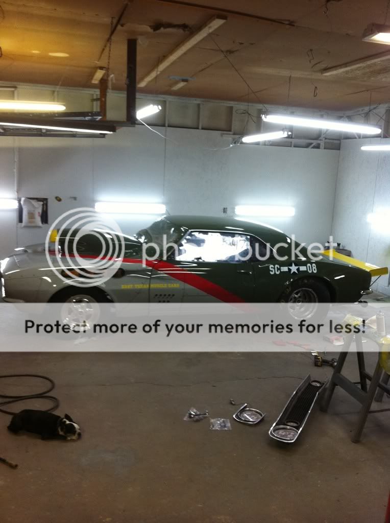

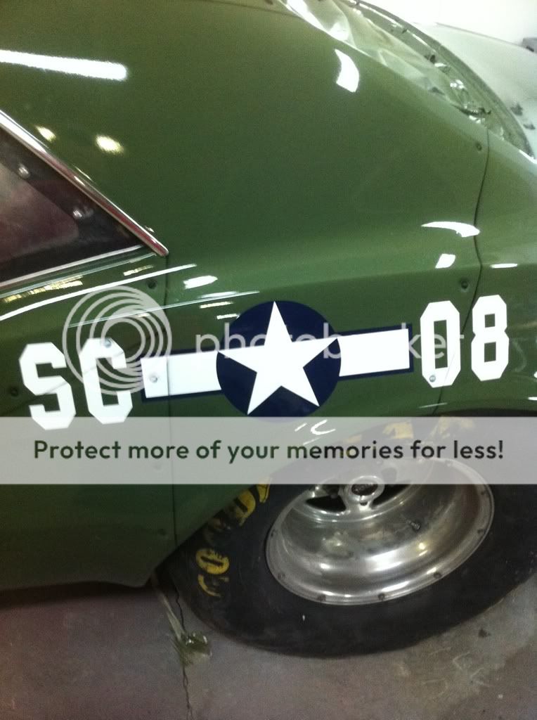

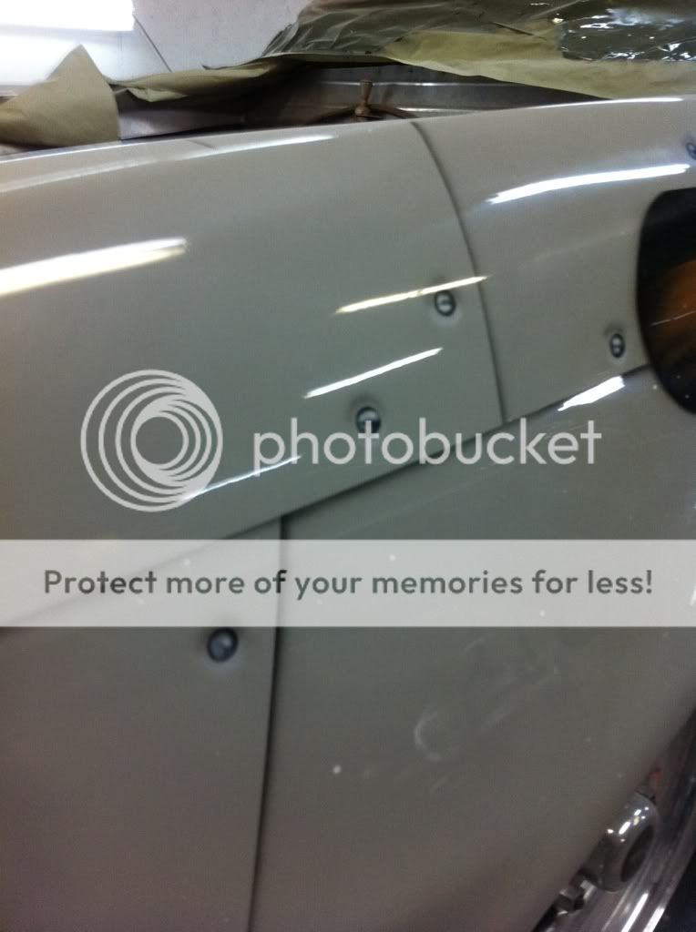

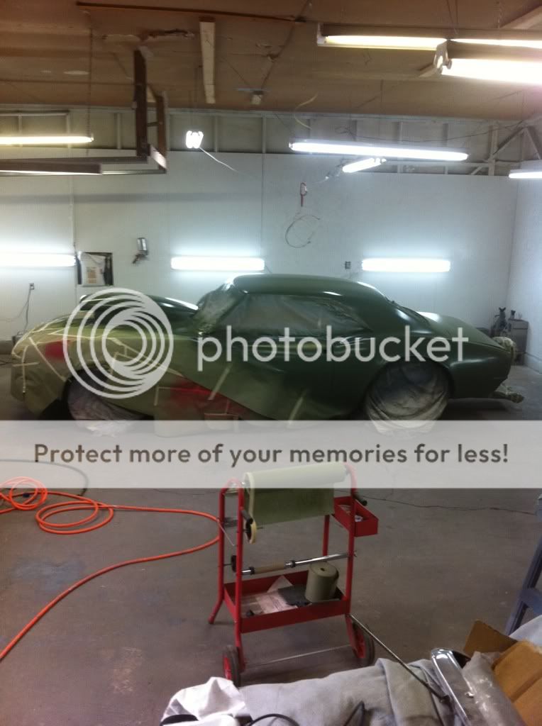

well we have always wanted to do a LS race car so we figured this would be the one to do it to. SOOOOOOOOOO first thing body work and paint job.

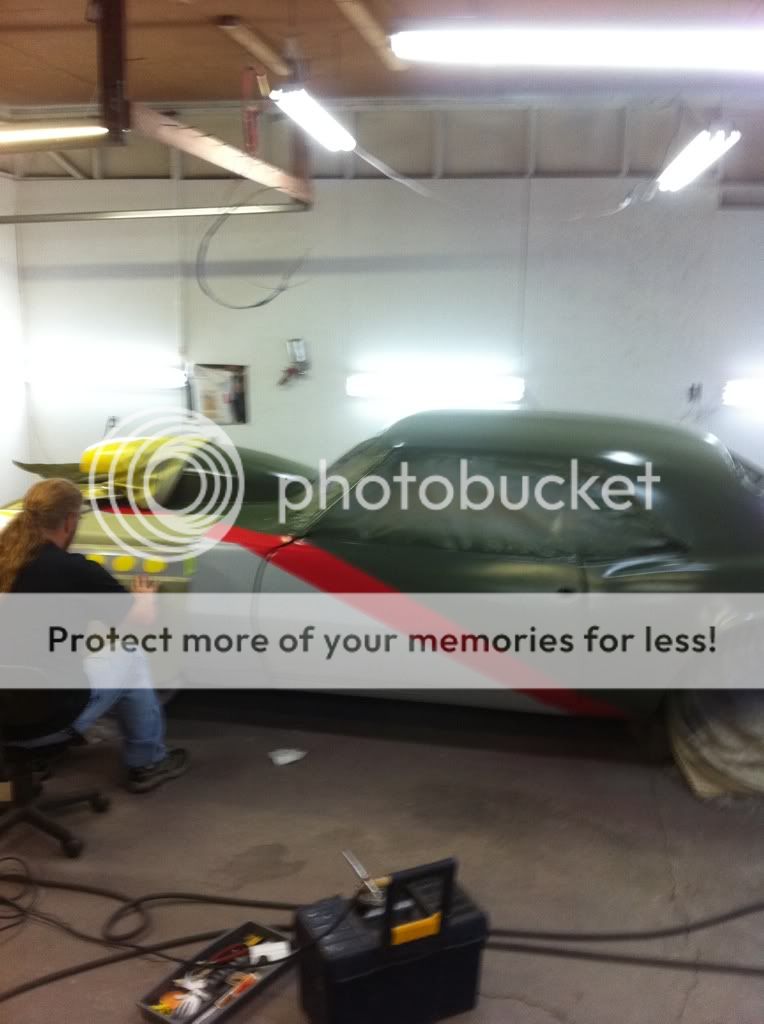

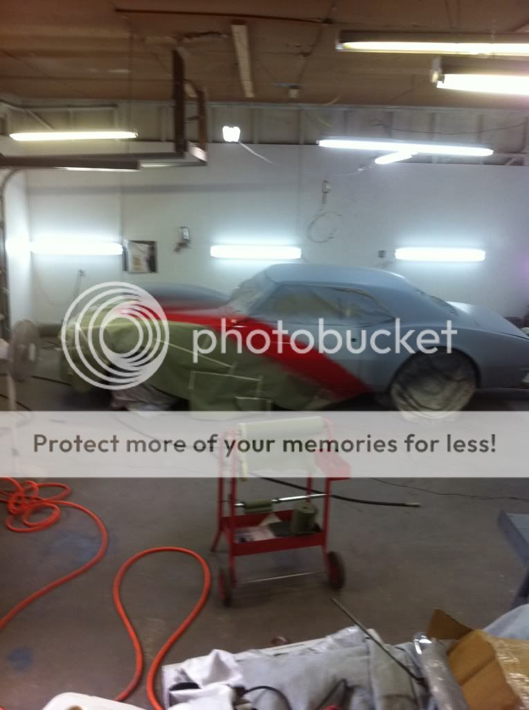

If anyone knows me they know im into planes. I was a aircraft mech for over 6 years and love flying . so i took a p51 paint job and put it onto my race car.
here is the plane i copied:

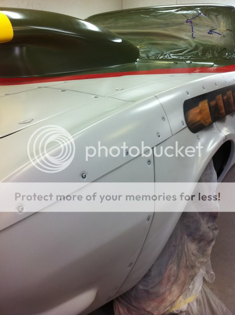

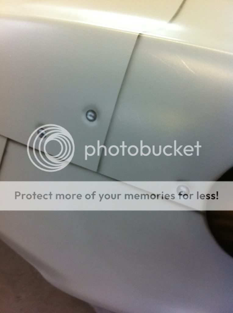

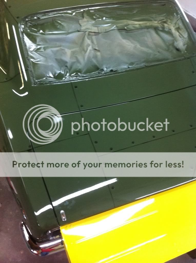

and here are a few quick shots of me painting the car a few weeks ago.
now for the fun time consuming part, the Airbrushing::turbonaug
and the final look
east TX Muscle cars is offline   Reply With Quote

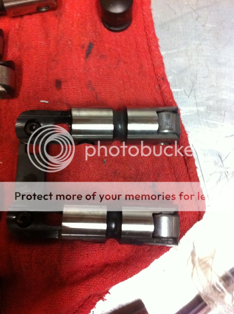

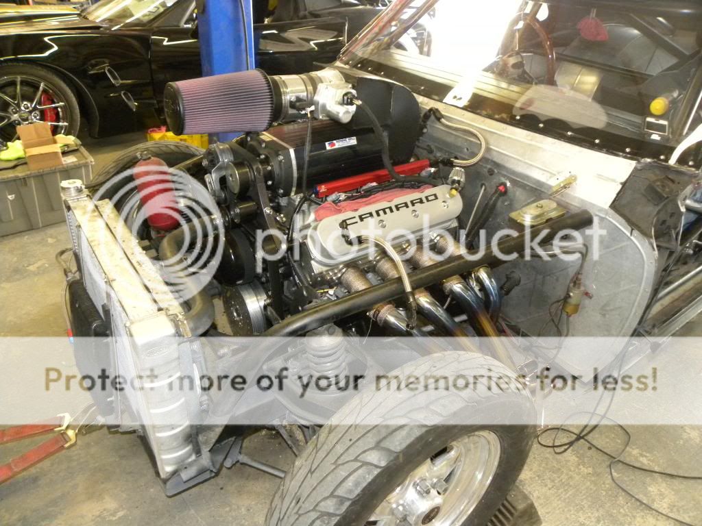

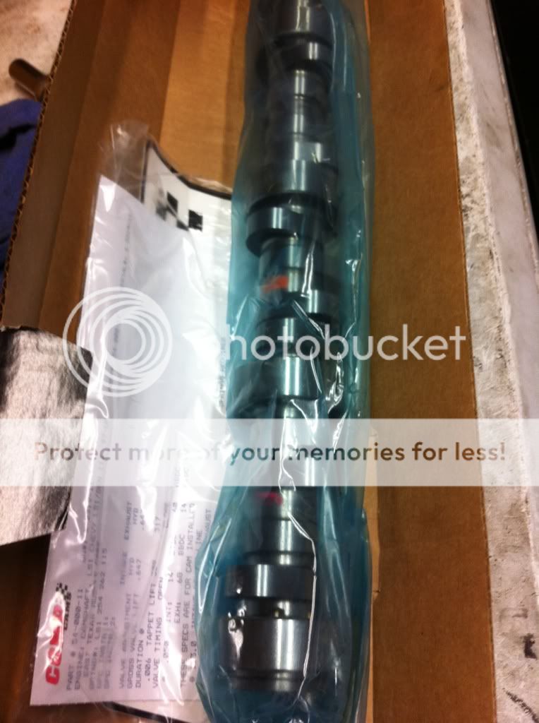

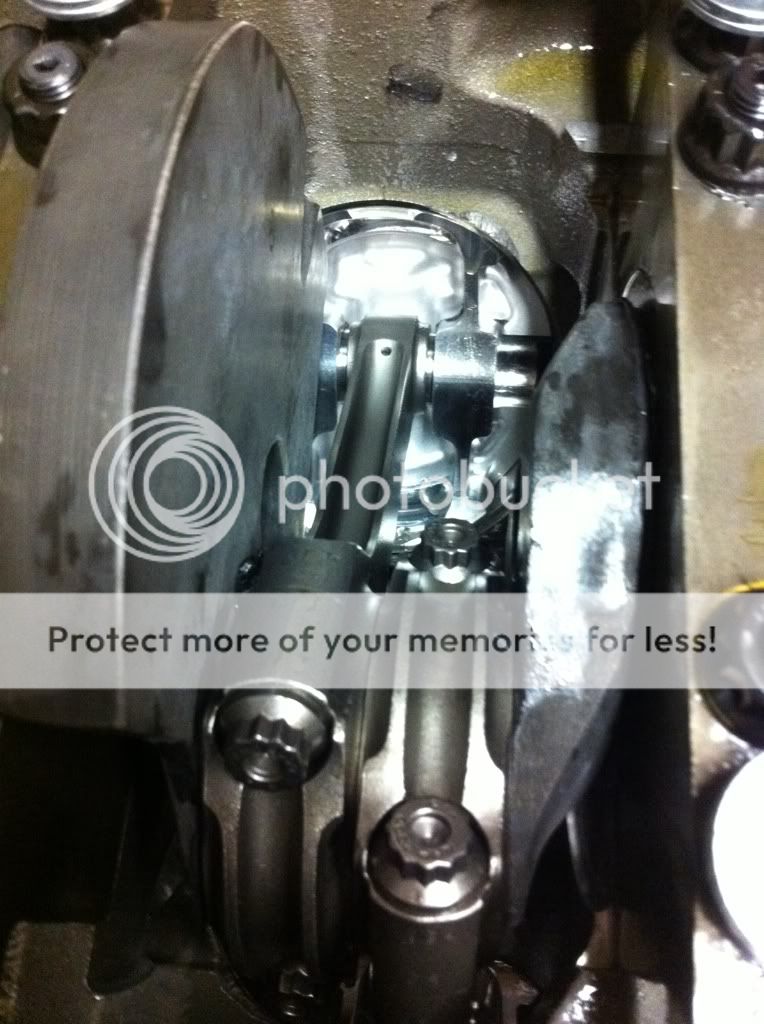

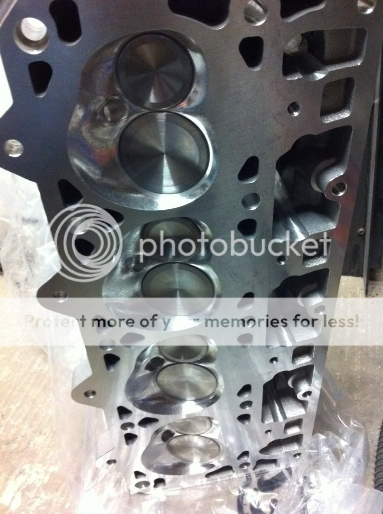

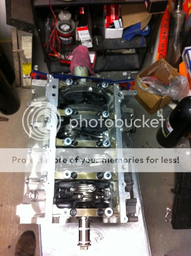

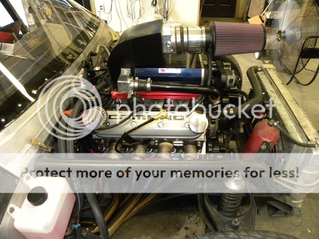

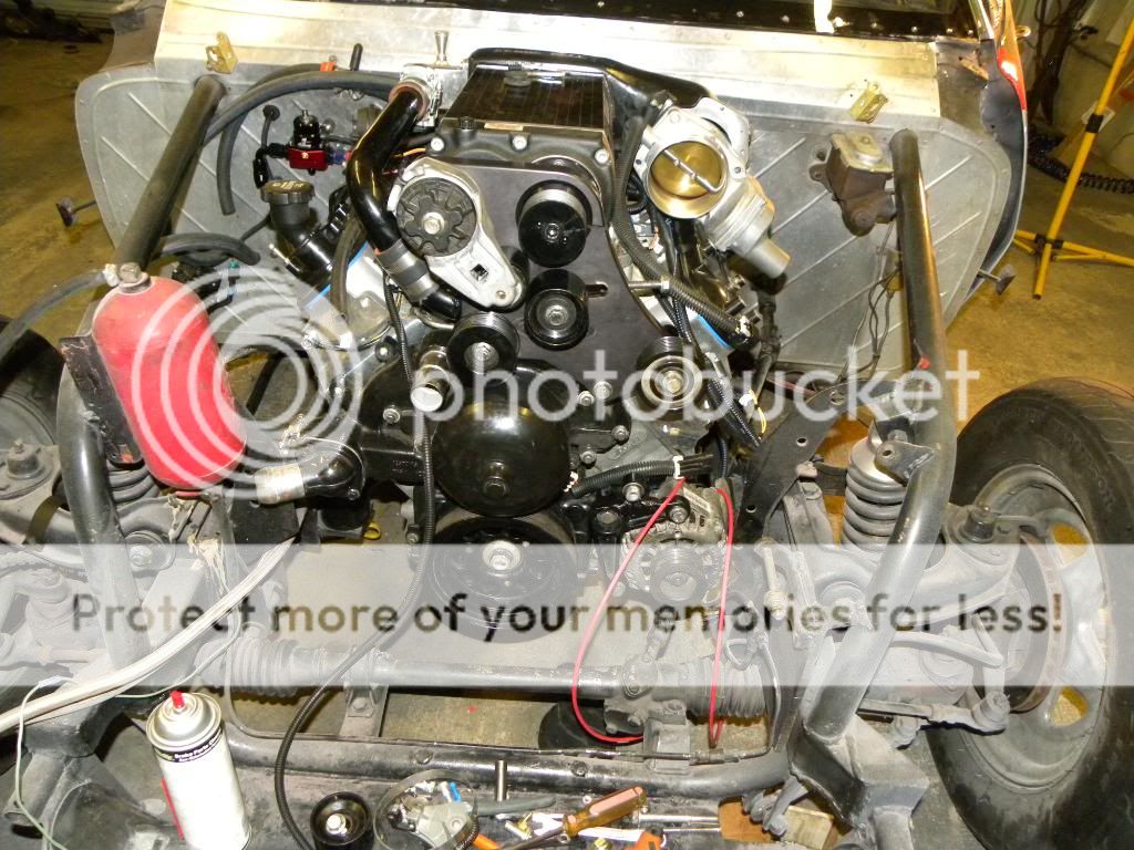

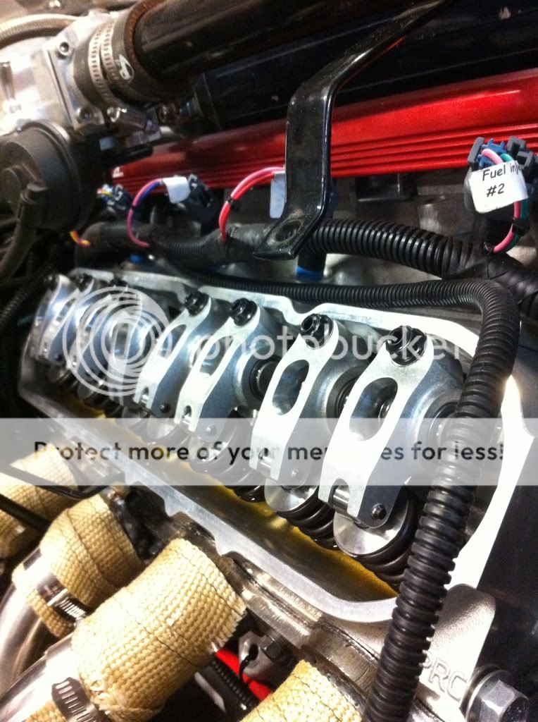

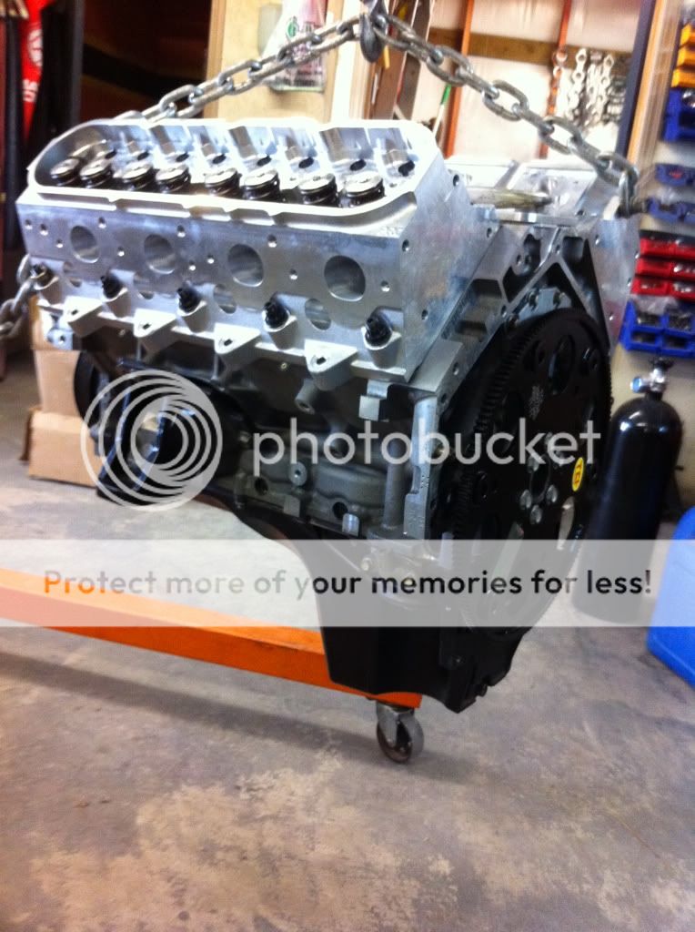

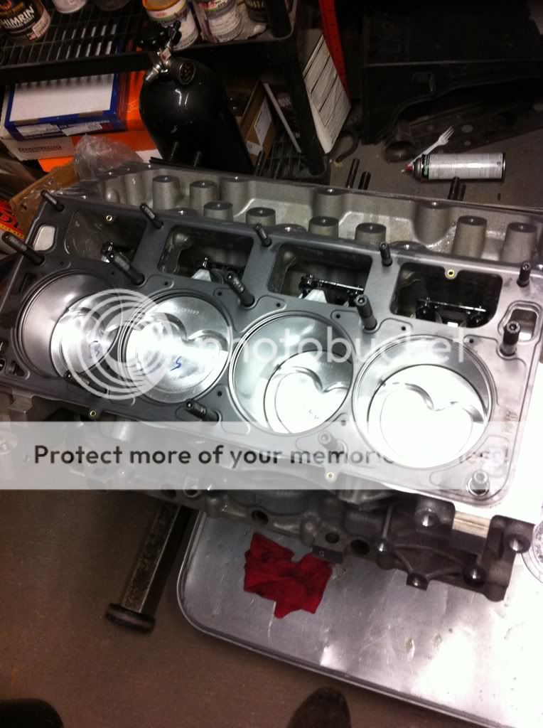

now onto the power plant.
418 CI ls3 stroker
CALLIES RODS
CALLIES CRANK
WIESCO PISTONS
PRC 237 HEADS
ETMC MONSTER CAM ( over 260/270 duration) SOLID LIFT
COMP SOLID LIFTERS
YELLOW TERRA ADJ ROCKERS

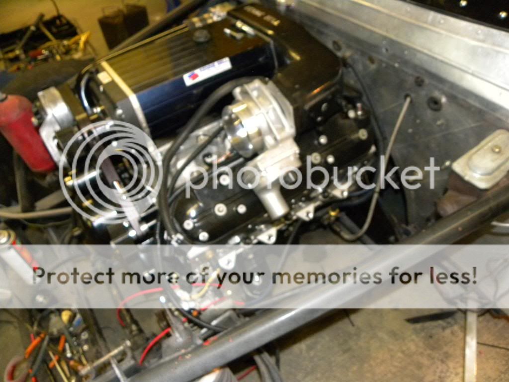

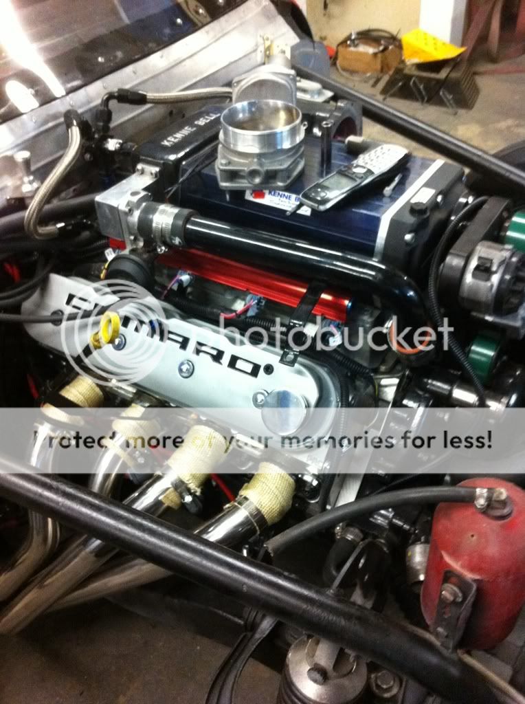

AND Big thanks to Kris for giving us a heck of a deal on his slightly used KB 2.8 blower that he took off when he domodded his car.

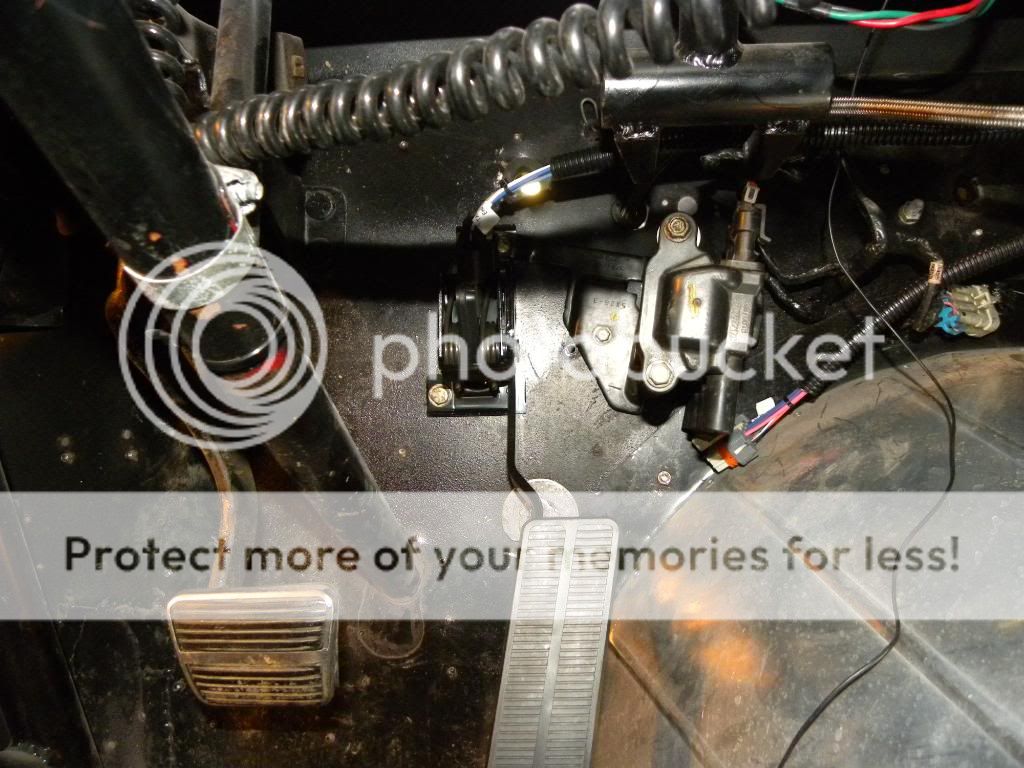

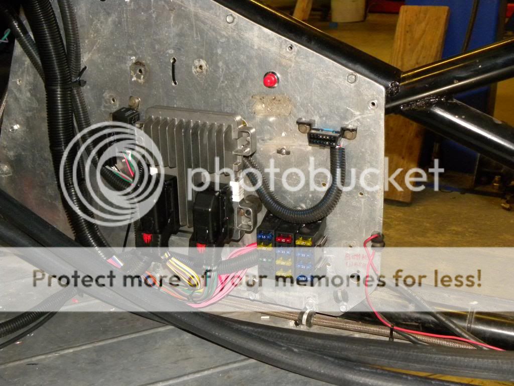

Car will be running the e38 computer
09 vette gas pedal
will have a MSD two step for launch control(5000RPM!!!!)
TH400 with trans brake that we took out of the 94 camaro
car already had a FAB 9" with 4.88 gears

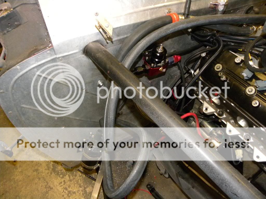

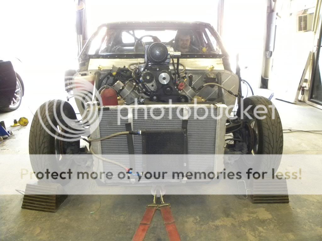

Car is a mess right now, lots of wires to tie up, lots of hoses to run, still alot to do.
BUT i think you get the picture of what the car will be like. lots more pics to come!!!

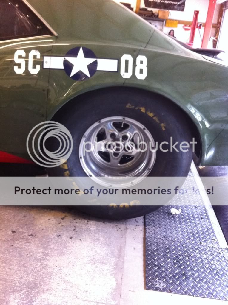

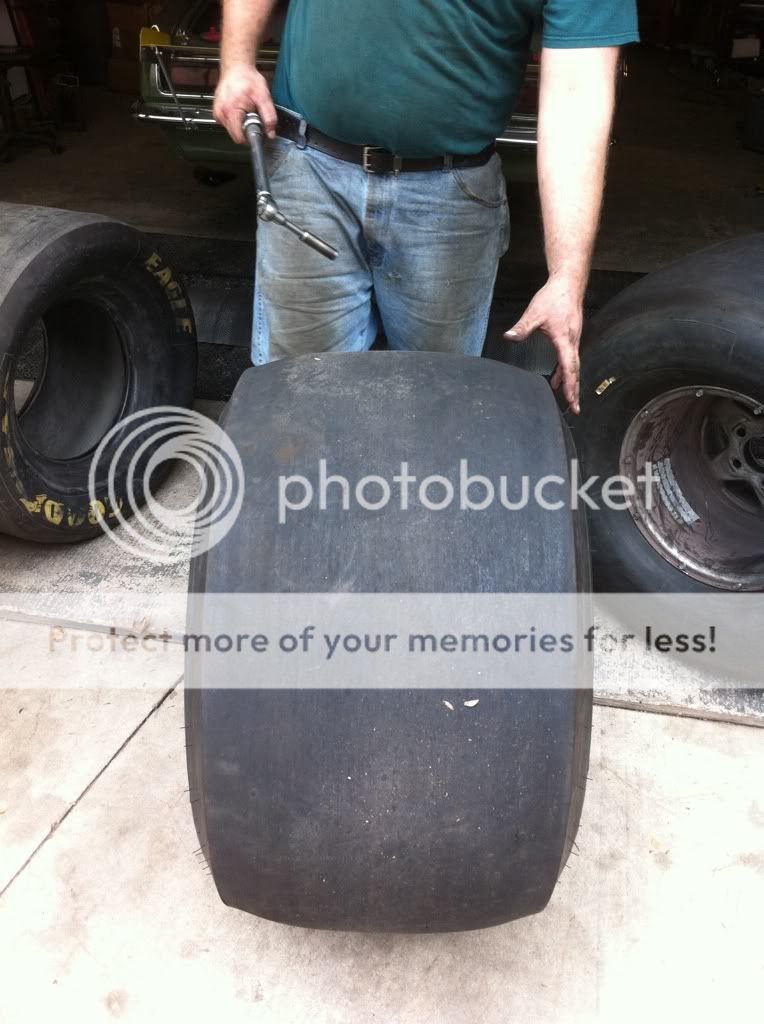

33x17x15 tires!
Old 12-28-2011, 07:23 PM   #11
east TX Muscle cars
east TX Muscle cars's Avatar
Drives: 2x 05 Vettes/65'AC cobra/68 camaro
Location: LONGVIEW, TEXAS
Posts: 845

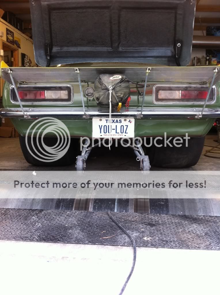

Car went on the dyno yesterday
8 PSI
on 100OCT fuel not race fuel yet
did 601 to the tires. the dyno shows over 200 HP driveline loss on this car. it can read neg HP reading to show you how much your driveline is eating up. these monster 33" slicks, the 9",th400 with a 5000 stall all eat up a ton of HP so we are VERY happy with over 600 to the tires on only 8 psi. more info to come as we turn up the boost next week and get some vids up!

ok well the car only could make 10 PSI without over spinning the little 2.8 so it was time to do a little custom work. I decided that the intake was a huge restriction so i made a new one and put a 102 MM TB on there.
now she is at 14 psi with no pulley swaps!
