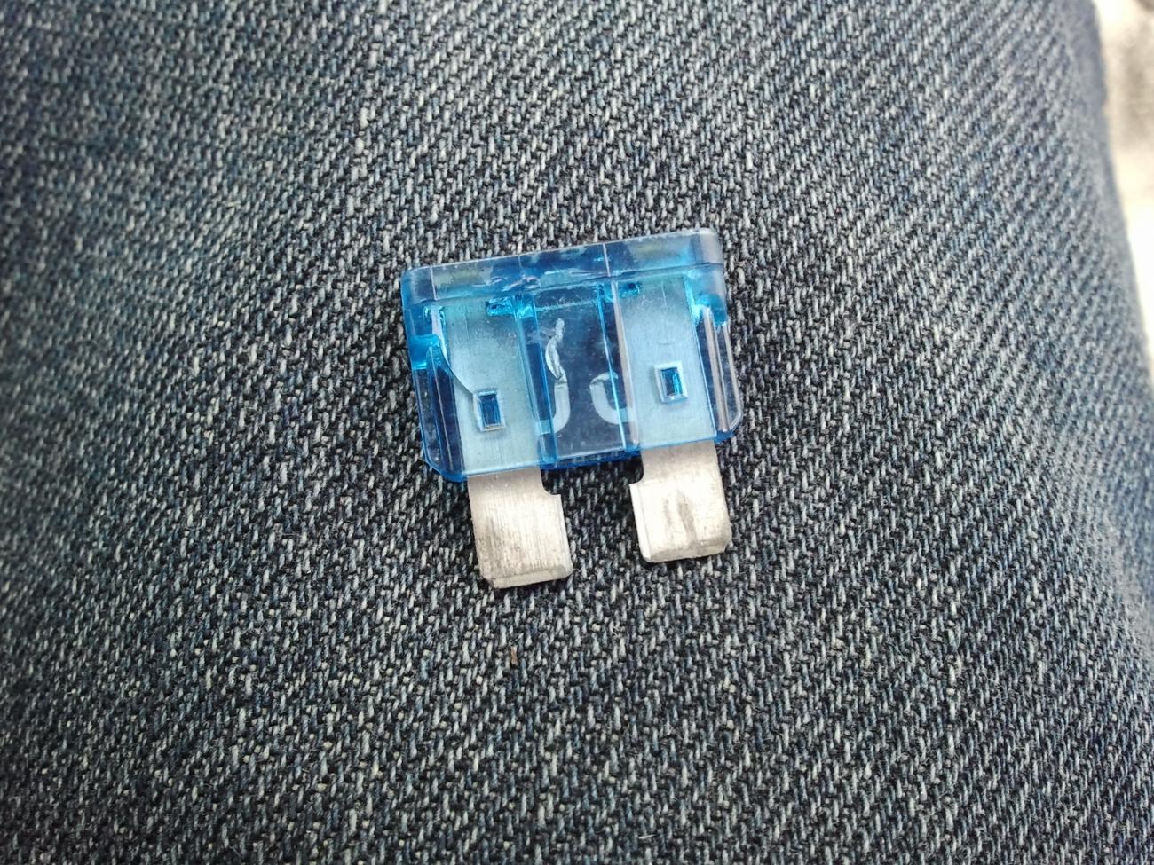

And my Corvette already had an aftermarket xplod 52x4 radio in it but was cheaper and didn't sound good. So me and my brother installed the new one. Every thing was wired correctly and the radio would work until we tried plugging in the antenna cord to the radio. The yellow power wire we forgot to cover touched the back metal part of the radio and it shut off. We went through and checked the radio fuses and every other fuse in the car. And the radio will not work at all, even with the engine running and a door open none of the interior lights will come on either. I think I royally F'd up! :( Please help me figure this out, last resort is to take it to CarToys and I would rather spend that money on other stuff.

Thank you Camaro5!!!!!!
I found it was the 15 amp fuse in the courtesy spot on the fuse box on the side! Thank all you for your help it is much appreciated!! Everything is set to go just need to get a new fuse and I'm ready to

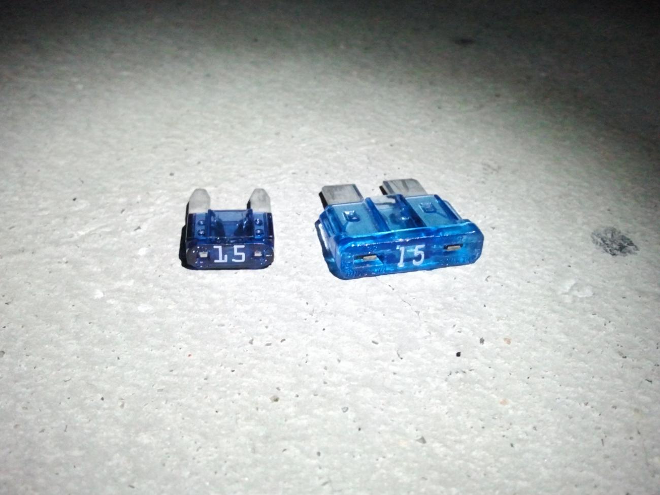

another question, will this fuse be sufficient for use in my Corvette, found it in the garage. It is a 15 amp but very small and wondering if I can still use it.
no it won't

Posts: 671
I fugured thats what it was...
A mini ATC fuse is ok to use in the place as long as your contacts are tight enough to keep the fuse tight in place.
