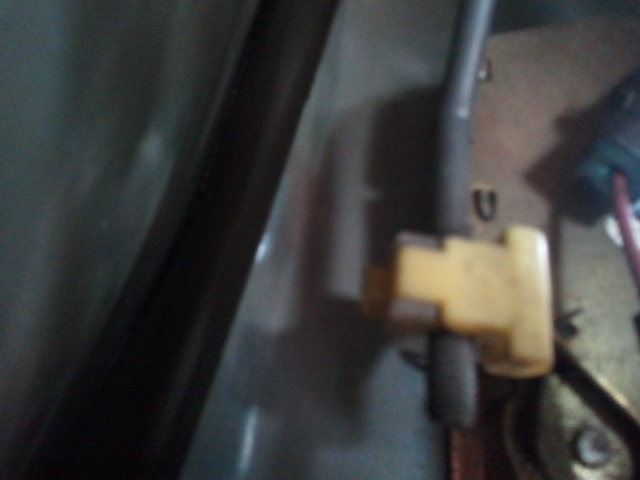

My left rear door is broken and wont open from outside, and I see exactly what part is missing. So I went ahead and took a picture of the part thats there on the right rear door. Can any of you guys help me of what it's called. I looked on directfordparts.com but I can't tell at all. In the picture it's the yellow part that connects the outside rod to the little lever that needs to be pushed down to open the door. Thanks, if I cant find this exact part just gonna have to go to homedepot and rig up something

It's a door lock rod clip.
http://www.dormanproducts.com/c-277-...rod-clips.aspx
http://www.dormanproducts.com/p-1236...0Lock%2520Clip
Look through the Dorman site, if they do not have it, it most likely is a dealer part.
You can usually find the clips in most auto parts store on the 'Help' rack.
