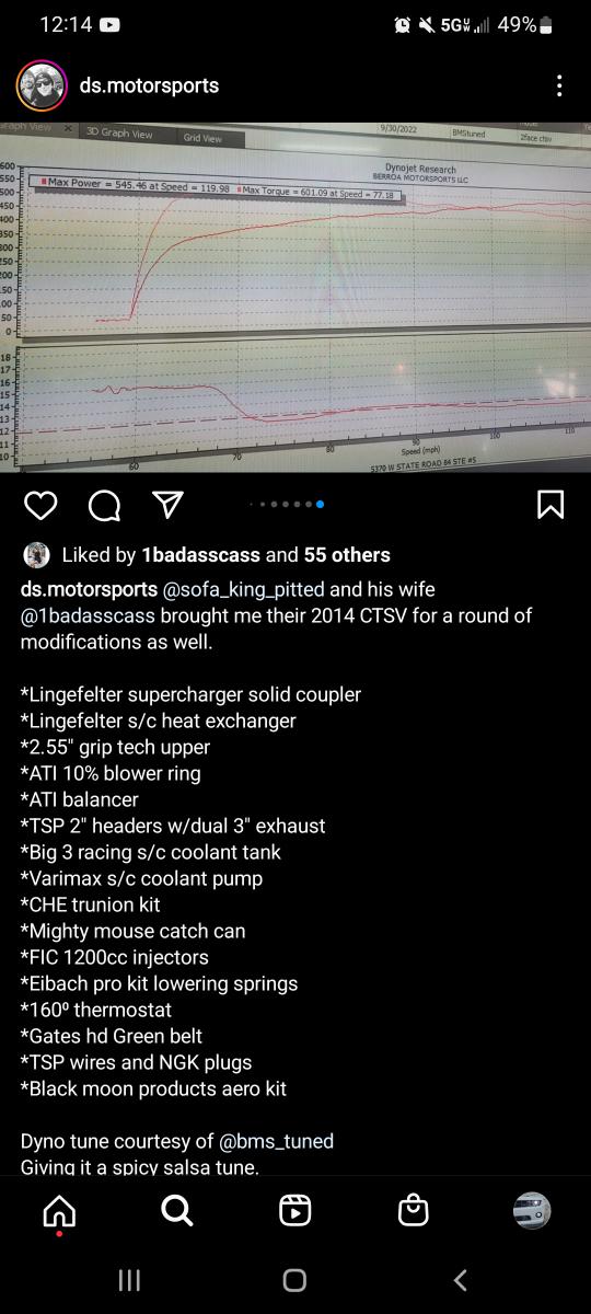

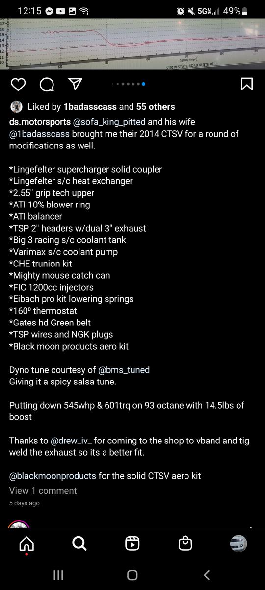

So, I know its not a ZL1. I know it's not a Camaro... but we are all LS and LSA guys here so bear with me. MY brother in law just had his 2012 Cadillac CTSV "built" by a local performance shop. All of the mods were done at one time and then the car was tuned afterwards...
-Lingenfelter supercharger solid coupler
-Lingenfelter s/c heat exchanger
-2.55" grip tech upper pulley
-ATI 10% blower ring, and balancer
-TSP 2" headers and dual 3" exhaust
-Big 3 racing S/C coolant tank
-CHE trunnion kit
-Mighty mouse catch can
-FIC 1200cc injectors
-160 thermostat
-TSP plugs and wires
-Gates green HD belt

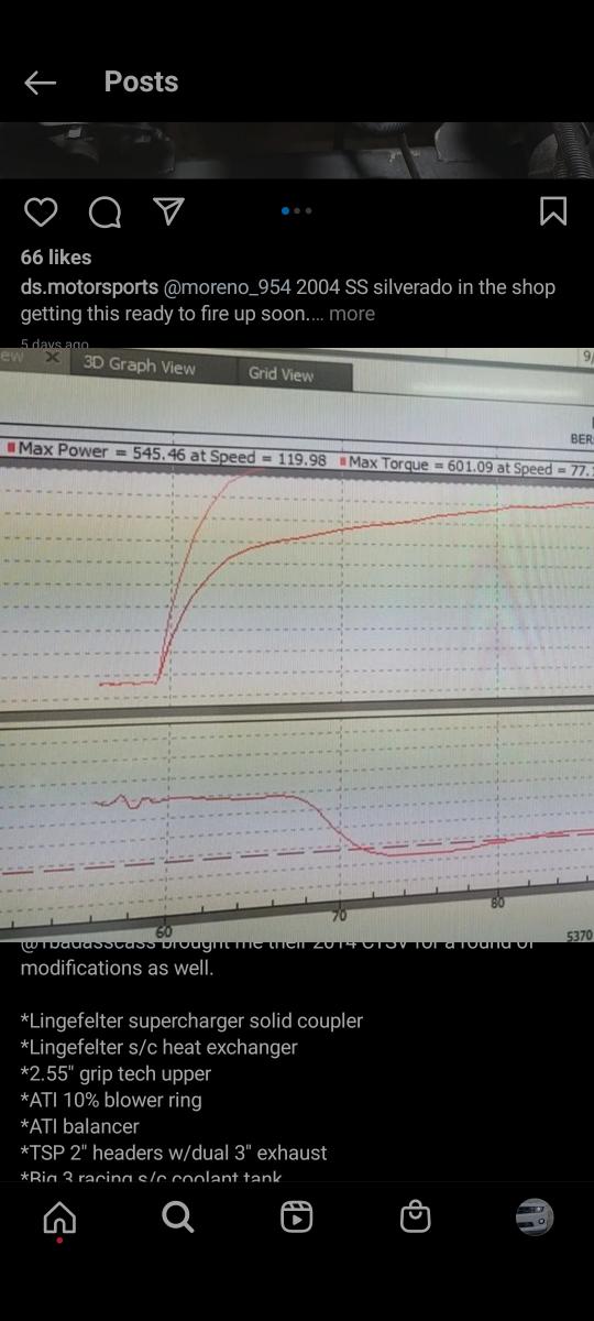

His dyno only made 545 rwhp and 601 tq on 93 octane with 14.5lbs of boost on a dynojet. These numbers seem really low to me? I feel like with this setup he should be making more power... but it is an automatic car. Opinions? Other then mods listed, the car is totally stock. Stock trans, stock diff and gears, stock converter.

Probably about right for an auto car with no cam. Add a stingy dyno and this is what you get.
The trap speeds tell the real story.

Alright, I agree that the dyno isn't the end all be all of cars and their power... I just wasn't sure if someone took advantage of him, or possibly didn't know what they were doing. In this scenario he took the car to a "performance" shop, and the had someone else come in to weld the exhaust, and a different shop dyno tuned the car. Just wanted to make sure he got his money's worth becuase I believe the bill was right around $10k. I think to myself for 10k I could have made my SS camaro much faster with that kind of budget. Thanks for the input guys.

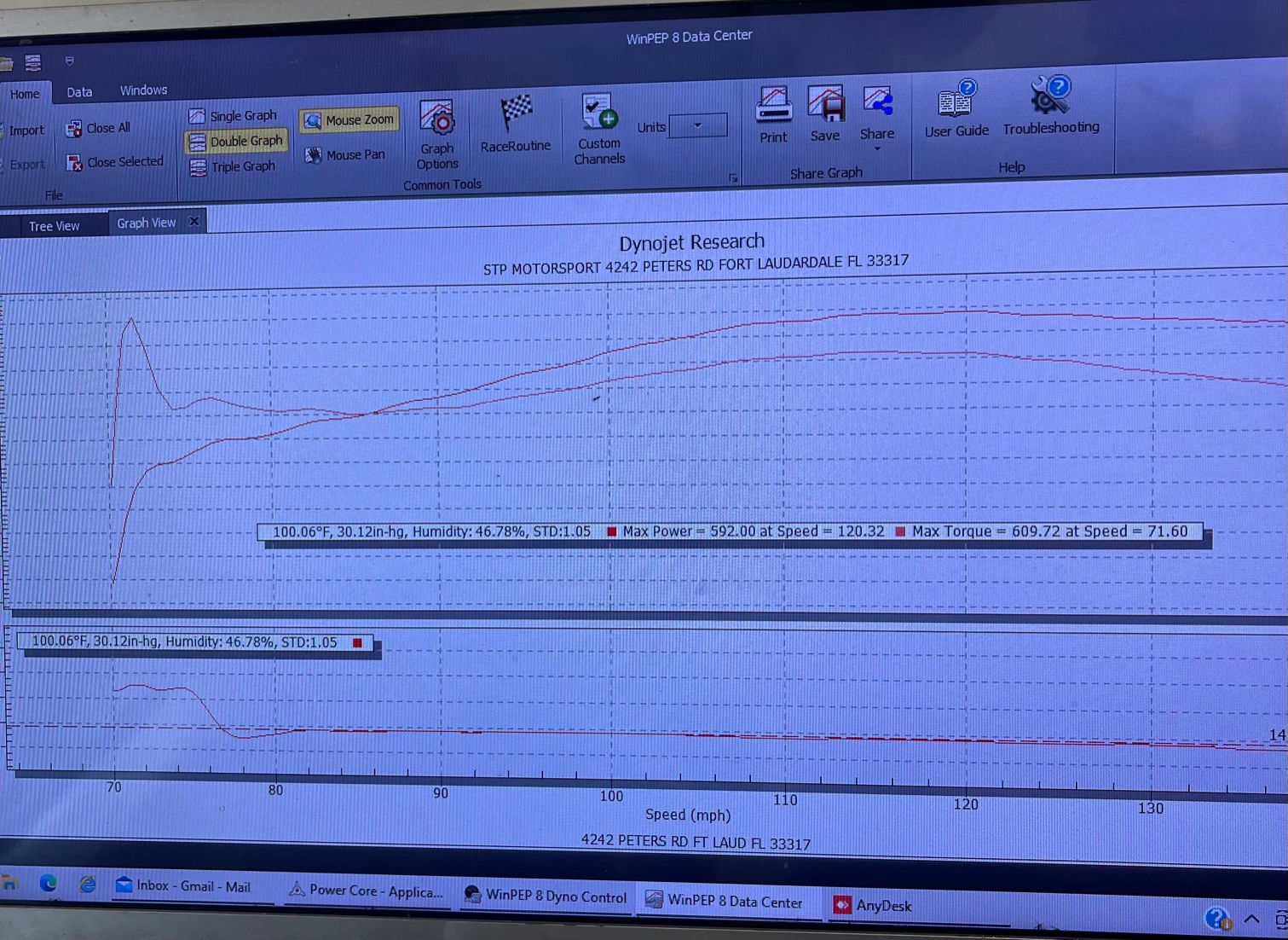

For comparisons sake, here is my cts-v dyno and mod list.
SW headers, no cats
fic 1200
2.55 lpe
36in heat exchanger
EMP pump, Ice tank underhood
airaid intake
DSX Flex Fuel kit on E77
I saw about 12.5psi and it would increase to about 13.5 at redline (probably due to the stock mufflers) I had the cut outs closed this run.
What I've come to realize about the LSA is that on the dyno, there is not enough airflow to cool the heat exchanger. You only get 1 good pull, after that it will lose HP the more you do pulls. Unless of course you let it cool down a lot between runs. We waited about 20 mins and it still lost about 50whp.
I now have a 2.38 LPE and DW300 pumps to maintain FP. (guessing about 620whp now)
Most people dont do a lower pulley until they install a cam. I'm guessing his car was heat soaked at this point if it was being dyno tuned.
Keep in mind, lots of guys run 10.9 at this power level with the A6. If they didnt tune the trans, you should reach out to Justin White. My A6 tune is so sweet. It's made me love automatics.
