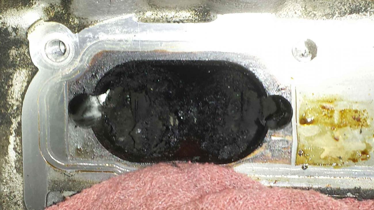

My wife has a VW CC and has 140,000 miles on it, she has used ARCO premium gas 100% of the time since it was new. Her company pays for her gas with an ARCO credit card that's how I know she has only used ARCO. Anyway, it started running rough and fuel mileage dropped. The VW mechanics had to clean the valves, they said it was because she did not use Top Tier gasoline. I hope everyone learns from this. It cost me $1200. Below are photos of the valves.

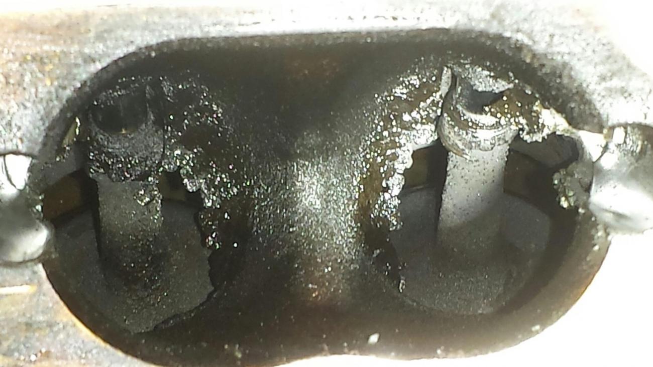

Another photo

Is her engine a direct injection engine? If so, not surprised. Has nothing to do with the gas.
Just looked it up. Yup not the gas fault. This is a known problem with direct injection engines. VW has some literature on this and people over at vwvortex has documented this through and through. This is a very common problem. In fact, her car is one of the worst and most known.
http://www.autoguide.com/auto-news/2...-engines-.html
Do a Google search, it's all over the web.

Yup and BMW 335ci's are notorious for this as well. Unfortunately it is the easiest way for an engine to have 1) better throttle response 2) more horsepower and 3) better gas mileage. It's like the holy grail. Except, after 20k miles, you have to get your valves and runners sandblasted (with corn or shells or something).
So, Chevy's new LT1's (C7 Corvettes, 2016 Camaro SS) and LT4's (C7 ZO6) have direct cylinder fuel injection. We'll have to see if Chevy found a way to keep this from happening.
In a direct cylinder injection engine, it is way WAY more critical to have a catch can or something to keep oil particles from entering the intake manifold/intake runners. Because no matter what fuel cleaner you put in, it won't do anything at all but clean your fuel lines and injectors, won't do anything for the valves or intake runners.

Top Tier gas is a good thing to keep in mind when possible, but as has been stated - there are other factors at work here. I can't imagine "bad gas" alone would result in THAT much sludge. Not to mention that the fuel never sees the backside of the valves, anyways.
Unfortunately, it sounds as though the VW mechanics don't know how their own engines work.

Direct Injection. The fuel has nothing to do with it as there is no fuel until AFTER the Intake Valves...
It being a VW with 140,000 miles is to blame.

In a Direct Injection (DI) Engine, the fuel is sprayed directly into the cylinder itself. The reason that top-tier gas doesn't do anything for carbon/gunk buildup on these valves is because the fuel never sprays across the valves. In Port Injection engines, however, this is a valid point.
An Oil Catch Can is a device that allows PCV gases to enter the catch can before feeding into the intake (and across the valves), allowing oil vapors to condense and collect in the can instead of down the ports, causing buildup.
With DI engines, the dirty vapors coming from the PCV system are leaving deposits on the valves, and there is no fuel being sprayed across the valves to keep them clean (fuel wash).
