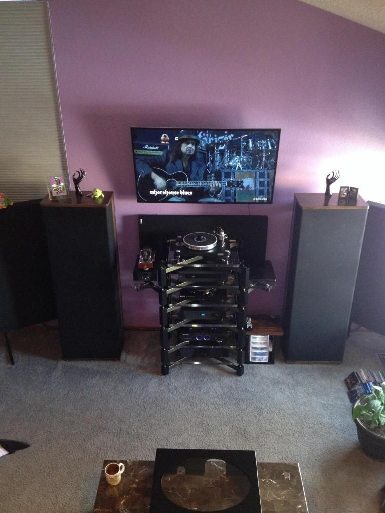

Have fun!! I love vinyl... I have a full record cleaning machine as well..
