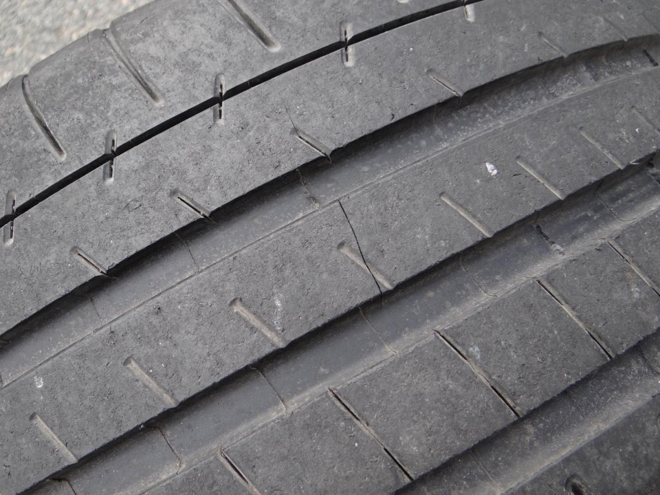

Cracks in Michelin "Summer" tires.....
I know this issue has been reported on other Corvette Forums but I thought I'd post here as well. My Z51 Stingray has 125 miles on it. The day I drove it home from the dealer the temp was 28 degrees.
During an inspection of the driver's side wheels and tires I found small cracks in the tread area of both tires. The front tire had the most noticeable crack. I have not inspected the passenger side tires yet. You really need to remove the tires to inspect them.
Not sure if this is a serious problem but I'll send photos to a friend who knows engineers at Bowling Green. I'll be guided by what he finds out.
Just wanted to give people a heads up.

I read enough about these summer tires that before I had delivery of my Z51in January I went ahead and bought all-season tires for cold weather use back in December. The summer tires are the greatest tires in the world for performance in temperatures above 40 degrees. In freezing temperatures they are not only dangerous to drive on but will crack due to temperature fluctuations.
If you decide to do the same I recommend storing the summer tires in a heated environment.

Thanks for the info. The car is currently stored in a heated garage. I plan to inspect the passenger side tires soon. If I find cracks in those tires I may just buy a good "all season" set of run flats and sell the summer tires to someone who tracks their Stingray.
Still waiting to hear from a friend regarding how serious a few, small cracks are to the safety of these tires.

Got a chance to remove the passenger side tires and found very small cracks on both tires. The cracks where in the treads. No cracking on the sidewalls. I have to say they appear cosmetic.
That said, I drove to my local Michelin dealer last Thursday. The person I needed to speak with wasn't there. The person I did speak with said he can tell me what the other guy would say. Basically, this tire dealer says I have to BUY a new set of the Michelin Super Sport Summer tires. The dealer will then ship my factory tires (now with 217 miles on them) back to Michelin and they will decide if the tires have defects. If so, I would get a refund for the new tires I bought. That's NOT going to happen.
I told the tire guy this was not acceptable. He agreed with me but said that's the way it would have to be.
I have the option of going back to my dealer or trying a 2nd Michelin tire dealer for a 2nd opinion.
The driver side front tire has the most noticeable crack. (Photo attached.) During a 91 mile drive earlier this week, with temps in the mid-50's, the tires were quiet and the car drove like it was on rails.
