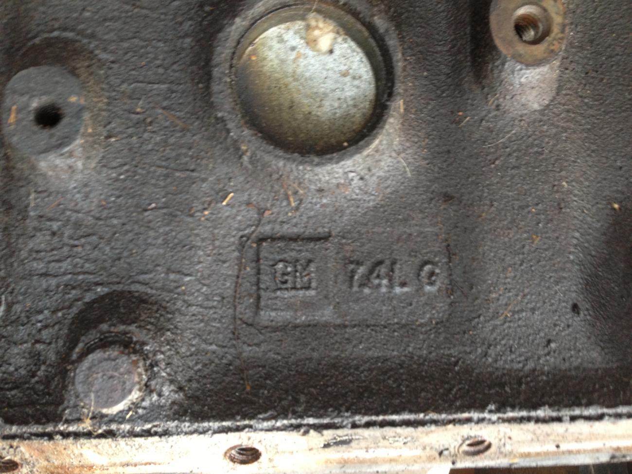

I am picking up this project today.
1967 Firebird convertible 400. He had the original 400 but traded it for a 454 motor that needs to be re-built. I am pulling the numbers from the block, heads, and intake manifold. I want to figure out what year motor it is. It has 7.4L G stamped on it which I thin means it is something out of the 80's.

I would guess something out of a truck? And congrats on the new project gonna do a build up show and tell?

In the 80's that was the only place they used the BBC.

Now if it's an 80's motor, it is definitely a truck 454. I would seriously go back to a Poncho 400 in it.

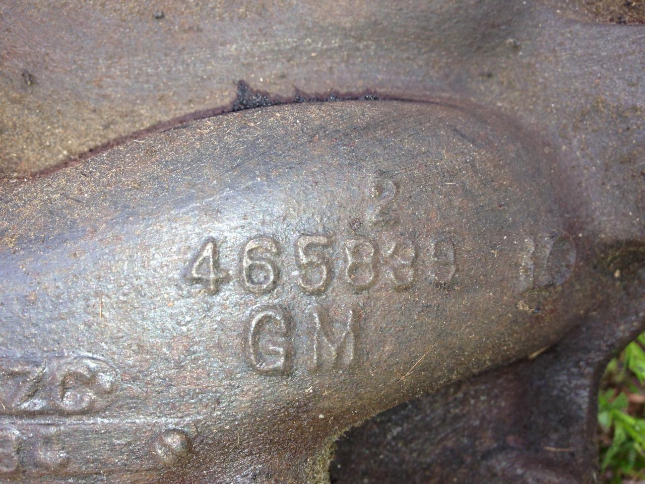

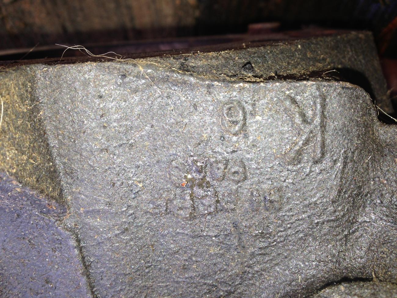

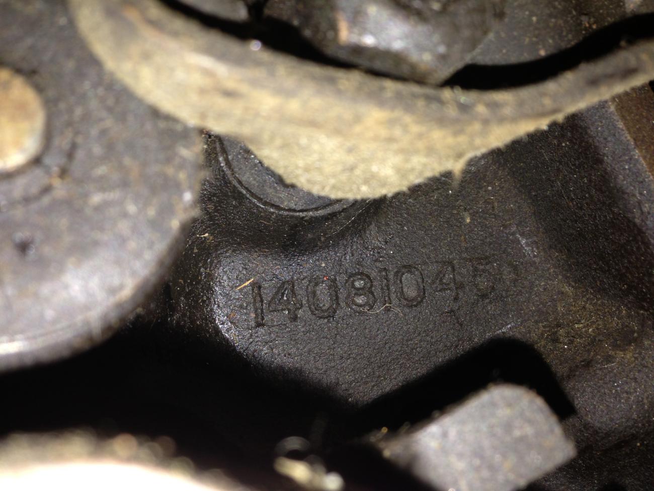

Block numbers,heads
Here are a few of the numbers.
