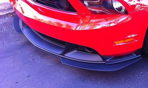

Agree... adds some downforce too. My other car has a variation... I also know someone who has tracked his consistently at high speeds and a splitter assists on keeping it grounded.
