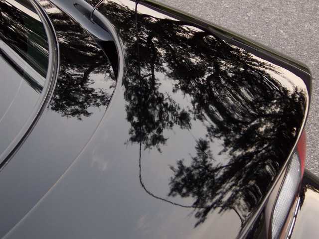

Check out what a little Meguiars Scratch X can do for your car.
Tuesday morning, I went over to a buds house for some 101 lessons on removing scratches from your paint.
Basically, I've had more and more scratches show up over the last year that I could not tell you how I've gotten. It looked like someone set down a box on the back rear of the spoiler and BAM...there were about 9 vertical scratches and one horizontal. All over, more scratches in the clear coat that when washed and dried, stand out like a sore thumb. It's been getting on my nerves.
I've used the Mothers Stage 1 polish, Stage 2 shine, and a coat of wax. But, it just doesn't get rid of all the scratches or all swirls. So, I called my bud who restores old trucks. We used various sandpapers on the clear coat cutting down a bunch of scratches making the beautiful black paint very cloudy looking. We hit it with some rough compound, then the stage 1, 2 and wax. I stayed up from 12:30am to 4am yesterday morning doing the hood and trunk. I used Meguiars Scratch X for a basic swirl removal on the hood by hand...applying and removing. I used Mothers Stage 1 w/ the orbital buffer, and then Stage 2 also w/ the orbital. I then applied the Meguiars Gold Class caranuba wax by hand and removed it by hand, polishing it w/ a terry cloth on the orbital once the wax was removed. I did this very, very lightly.
Now...for the pix.
Before and after on the spoiler. There were some pretty good scratches here. You can see the swirl marks in the clear coat in the first two.

Right after the Meguiars on the first 3 and during the final wax process for the last two pix...

The first three are kind of far back to where you can't get much detail in the paint. But look at the last picture. This is the picture that says it all. It is the same angle that you see from the other before picutres. Meguiars did one heck of a job for me on this one. I must say this has seriously impressed me!!!

Thanks, guys. I woke up early and finished the caranuba on the entire rear bumper, back quarters, and the front quarters this am....not like it's going to really make a difference seeing as though it's raining due to tropical depression Erin... Where the hell did this come from??!!??
I just saw that you can see the black tube of Meguiars on my windshield wiper from the garage before pix.
Something I also wanted to mention was some stuff called Back to Black . I have heard of it before, but never have used it. Well, we used it on all the hard, black plastic on the wipers, the window trim, the t-top trim, and other hard/soft black plastic. I was, to say the least, amazed at how it returned the parts to their original gloss black shine. I was told that it should only last about a week:( , but I can't tell you all how much it was worth it. It looked like it should have when it was driven off the showroom floor. I didn't realize how bad it had gotten until we hit it.:eek:
As far as the spots on the camera, yeah...it's been driving me crazy. It's a very nice digital Kodak that was dropped a while back. The outer housing is loose and maybe I got some condensation in there causing the spots. But, they have been there for years. Maybe if I have a few minutes today, I'll drop it off at the shop. Hope so...but thanks again, everyone.
Originally Posted by SSMUFF View Post
Looks great. What orbital do you use? My Jeep is black and man those tiny marks bug me to death. Need to someday try this myself.
I use a 10" Ryobi orbital buffer. I have about 10 of the applicator bonnets and 10 buffer bonnets. I use all of them and sometimes have to wash them to continue.
For those little swirl marks, use the Scratch X. It's a light abrasive, but I'd do it by hand. Rub it in good until you almost rubbed it off and then let it dry. Use a microfiber cloth for that and another clean microfiber for removal. I used the orbital for stage 1 and 2 but changed out those pads quickly.
If your scratches are deeper than just a very minor clearcoat issue, then you might want to look into a rough, heavier compound and maybe even wet 800 grit sandpaper. Start w/ the rubbing compound by hand first and see how that goes. I've wanted to learn how to do this sandpaper bit for a long time now and I've finally got it.
