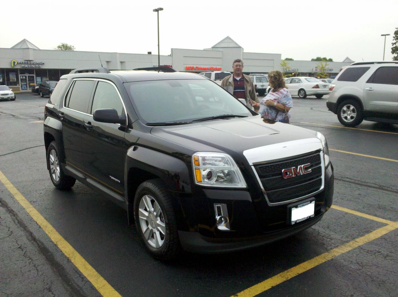

Well my parents bought a new car tonight, a 2011 GMC Terrain. It's a pretty nice car, they went with the 4 cylinder to save some gas mileage. So the Cadillac is officially mine to do what I want with. I'm going to make some calls tomorrow to see how much it would be to repair. I worked in a diesel shop for 5 years through college, and have rebuilt quite a few diesel engines, but I don't have the time or space to fix the head gasket on this car.
