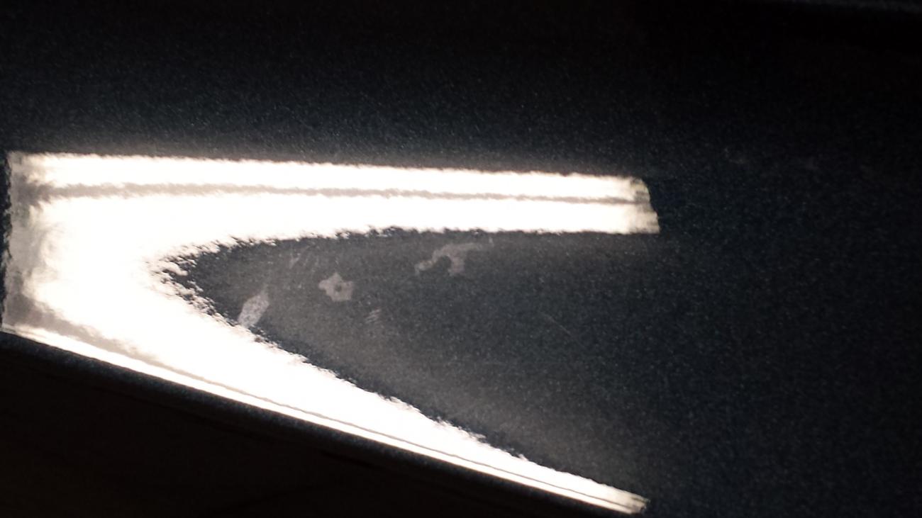

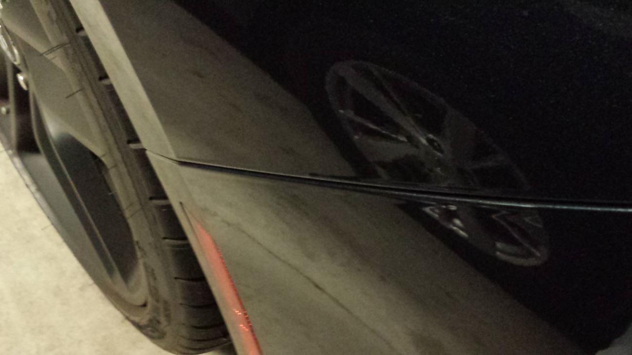

ok what should I do? The dealer that I bought my NRB 2lt made me come at night, I tried to come in the day but, he told me that there was a buyer coming to pick it up in the morning the next day. The next day I noticed, I had some paint issues and I also had a dime sized circle where the vent was that had no paint. I got the hood touched up but the orange peel is killing me, if you look at the passenger door its wavy and almost rippled. Have some spots on the panels, and now strangers are starting to point them out, my vin is 1077 and I understand that QC at BC has gotten better, How should I handle this because my local dealer didn't sell me the car and I don't want to come off as a bitchy customer...... also what's all involved in the fix? wet sanding?

Posts: 103
ok its hard to capture the ripple on passenger side door.Name:  vette1.jpg
Size:  72.9 KB[ATTACH][ATTACH]Name:  vette4.jpg
Size:  65.0 KB[/ATTACH][/ATTACH] both sides of rear panels have lots of paint build up, driver side has run w drip. and there is trash in paint, kind of hard to capture,

Posts: 103
Now the dealership is saying that this is normal......the last pic is of a weird dull spot on driver door. hard to see.
